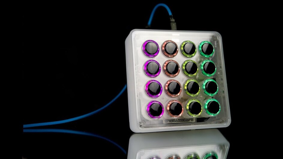

Instantly thought of Midi controllers. Mixed with some good software these look insanely fun to play with. The arcade buttons also add a bit of fun and familiarity to the product too.
The success of platforms of a platform like guitar hero, shows there is some good opportunity to explore music/electronics/game space. Combined with an educational UI could make it interesting.

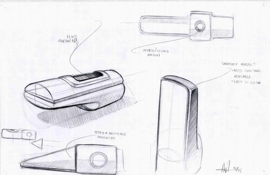

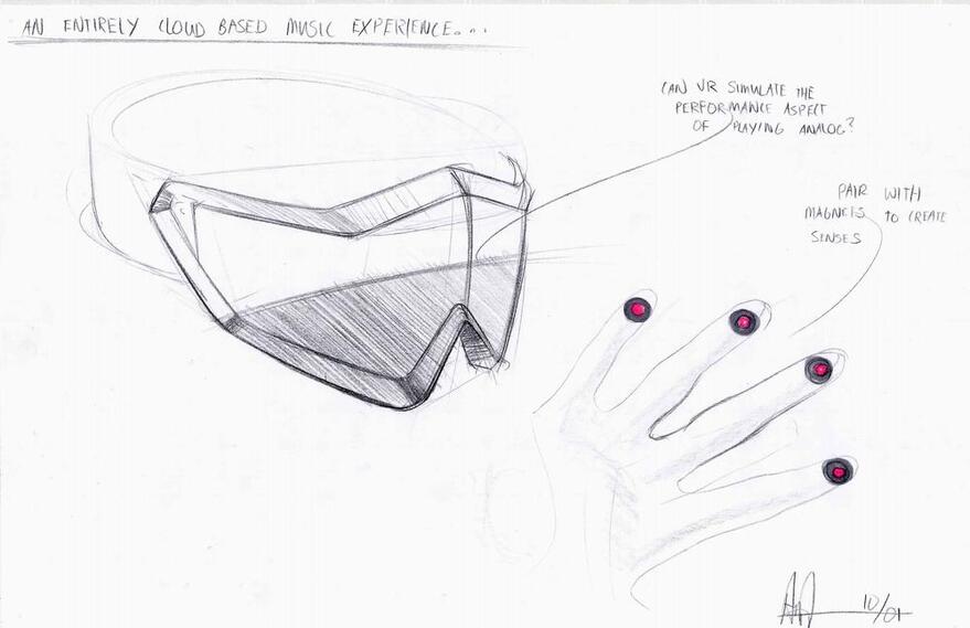

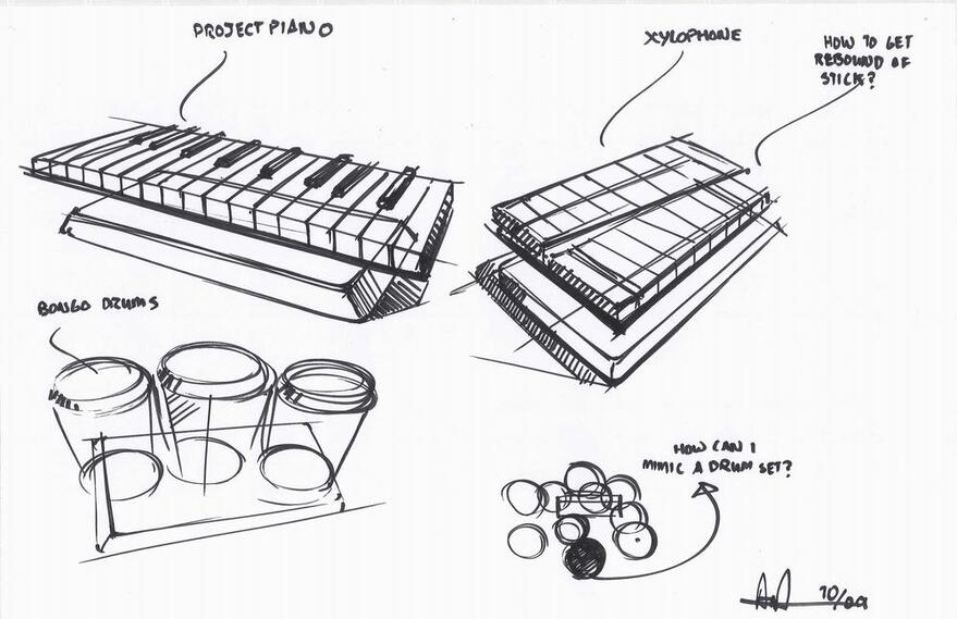

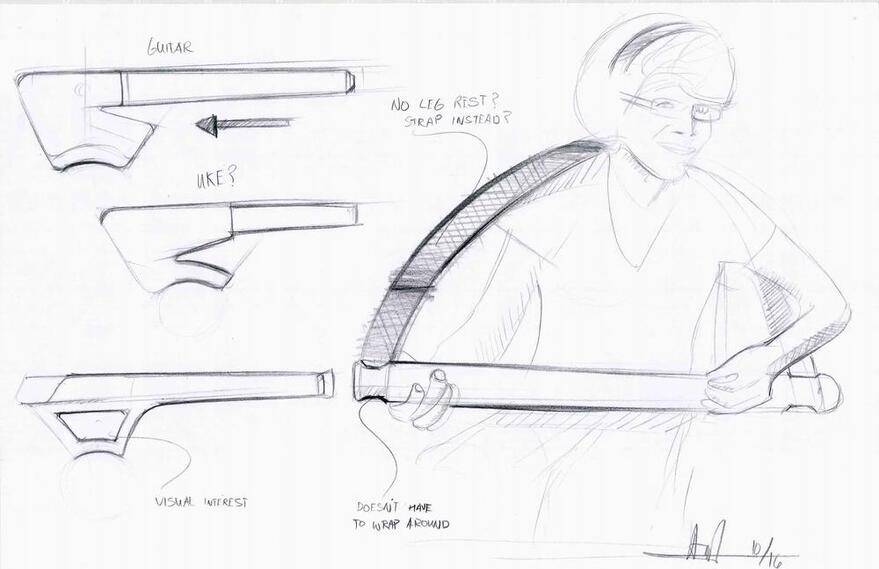

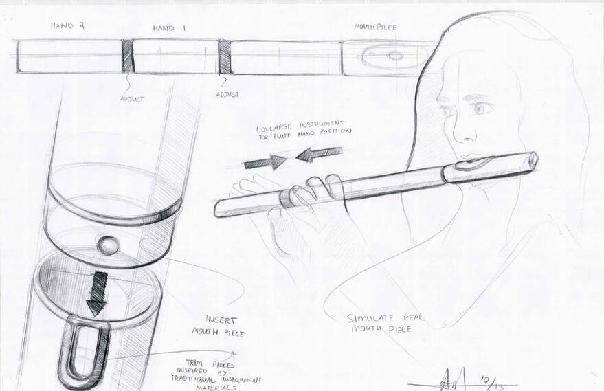

In 6 weeks the project has gone through quite a lot of changes and iterations, here is my new direction and mission statement, I’m going to upload images of mockups and sketches later tonight.

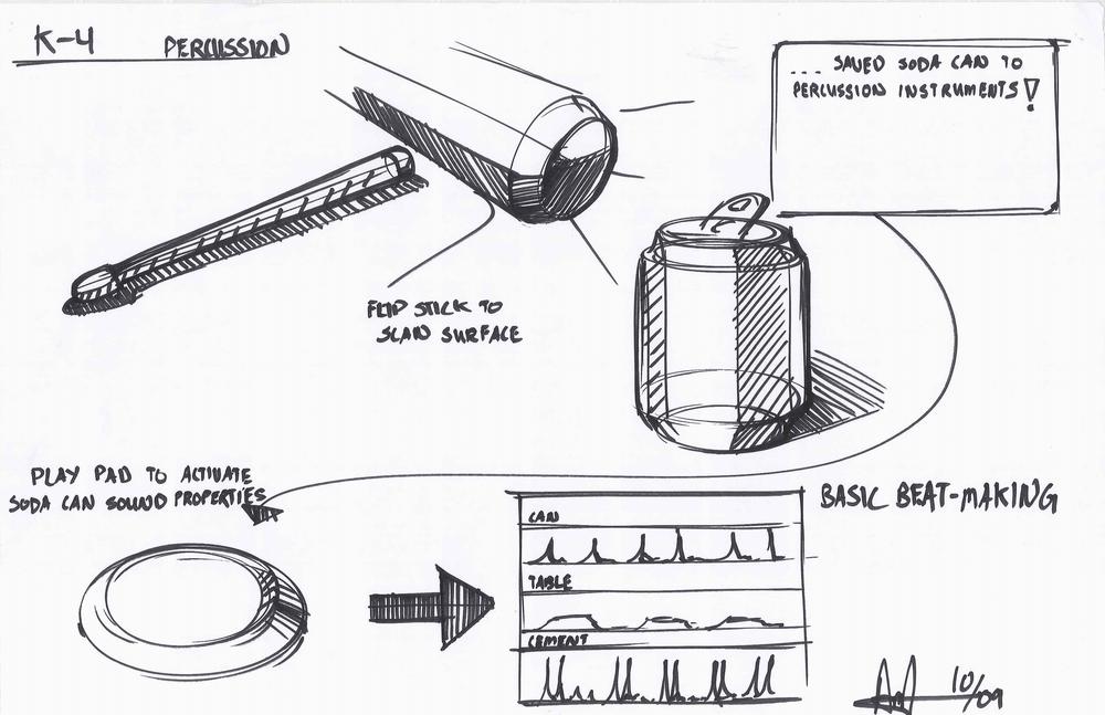

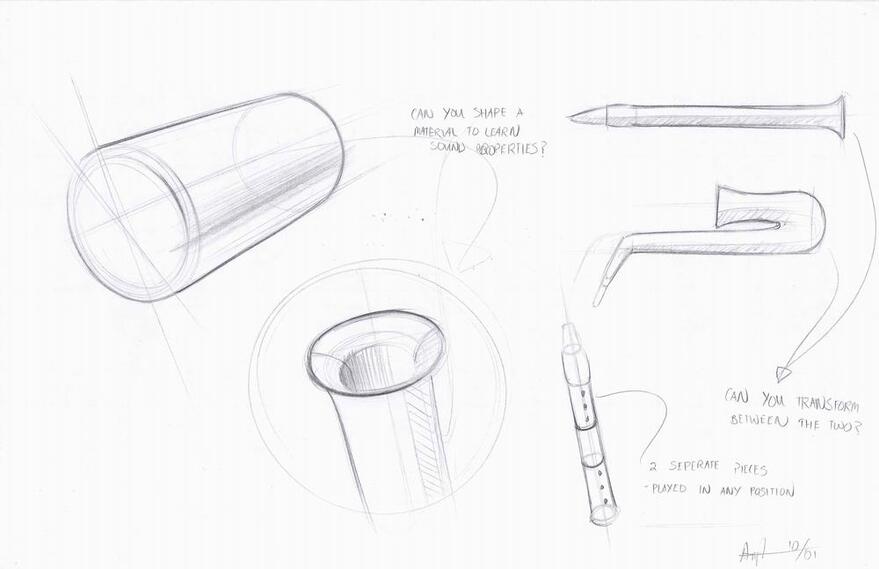

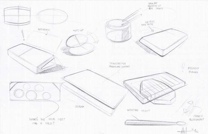

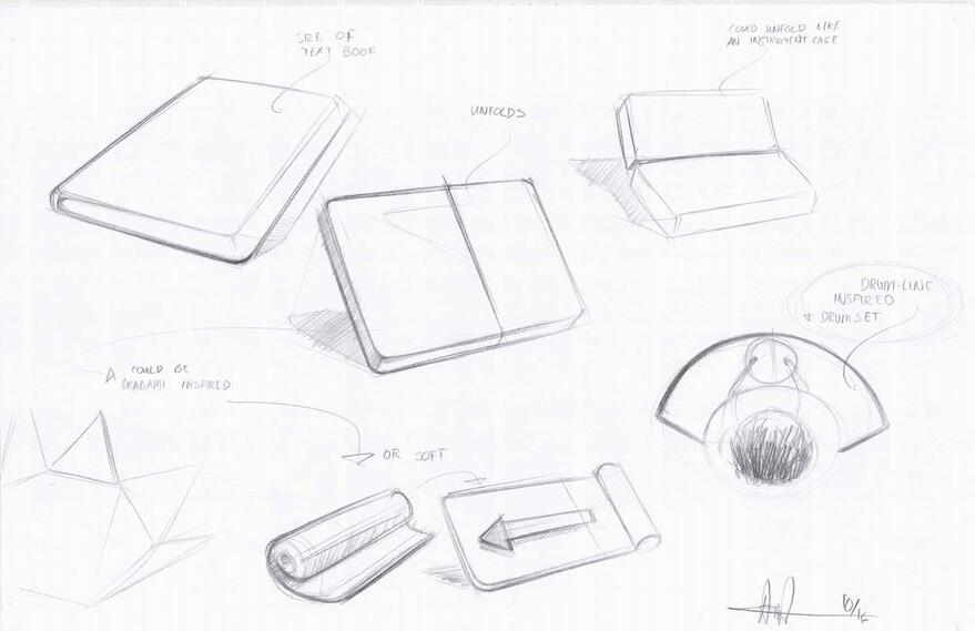

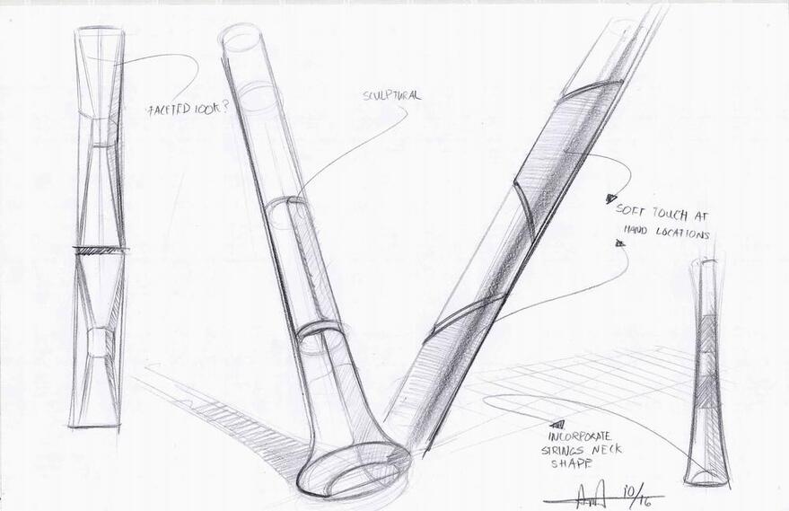

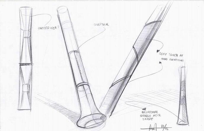

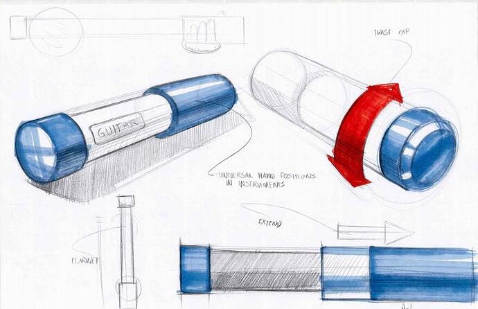

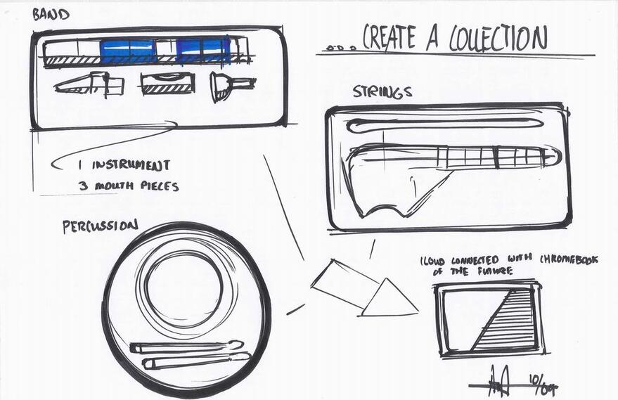

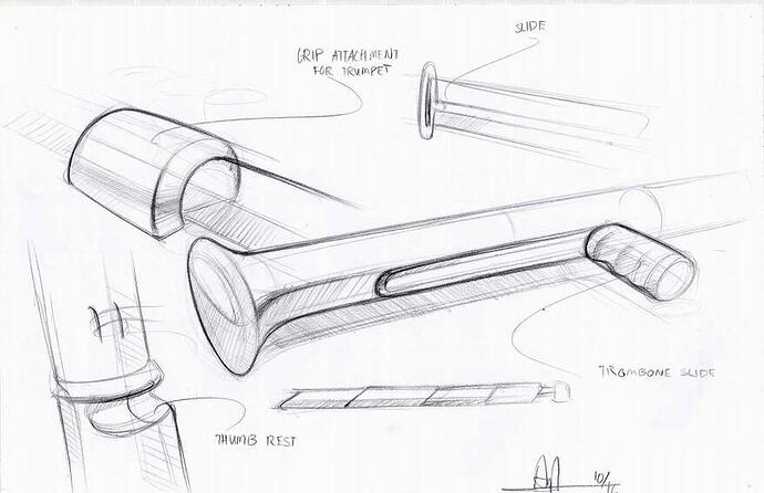

Exploration sketches:
Here’s how it was presented for midterms:
During my exploration I was thinking about creating three instruments which covered the core traditional, contemporary, and digital music process. However, from talking with teachers of many disciplines, and a handful of music teachers, it dawned on me that even though I had a very contemporary music education experience (guitar, bass, drums, etc.) many programs are still stuck in teaching how to read sheet music, and playing classical music. After 6th grade, when students aren’t required to take music class the enrollment in music education drops dramatically, so how can I make something accessible and relevant to students in the K-12 education system. My direction moving forward is to create one product which covers contemporary music, this means guitar, bass, drums, and keyboard because these instruments can be applied to nearly all of music.
I’m projecting to the year 2025 because I want to show my thinking on a topic that I don’t think many people are looking at. I hope that this sort of forward thinking is what Google X is looking for and based on the intern portfolios I have seen I think I’m on the right track.
I’d love to hear your guys’ thoughts and answer any questions or concerns.

Really interesting projects. I’d love to see larger images of the sketches, the text isn’t legible in the current size. I think the idea of getting more engagement from the students by having them create contemporary music, possibly focusing on composition rather than on interpreting existing songs makes a lot of sense, especially at a high school level.
From my experience in high school, many of us were in bands, some making rap beats and recording friends rapping, lots of singers. However, the music class wasn’t the hub of all of this, it all happened outside of school. The only exposure we could get was at the year end talent show.
My questions would be, how would a group of musicians interact together with these contemporary instruments? How would the classroom be set up? And also, how would sound reproduction be handled? You can make a drum sampler fairly cheaply but 808’s don’t have the same lustre when coming out of a phone speaker.
For earlier years I’d love to see an orchestra of cheap instruments. Something like the plastic recorder but with a more pleasing sound and with instruments playing in different registers.

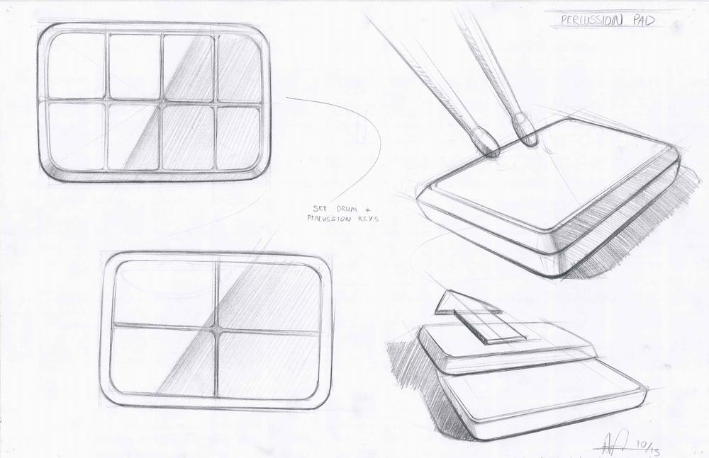

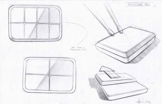

Thanks Louis, that’s definitely the goal and I’m glad you think it’s a good direction! I’ll attach my sketches below in a larger format!
Now that I’m getting closer to my product direction I definitely see the holes in my project going forward. I’m not sure how the interaction between the instrument and interface will be. Since I’m projecting for the year 2025 I don’t want to say that the learning interface is a Chrome book but I’m trying to find the balance between conceptual and going full star-trek.
Same thoughts as far as the audio goes, much more exploration and figuring out to do!
I’ve had the idea of a cheaper, more simple version for young kids in the back of my head that encourages exploration. I was thinking about a basic percussion product, maybe something that a young student could record sounds and make them into loops and then drum to them. I’ll sketch on this tonight!
