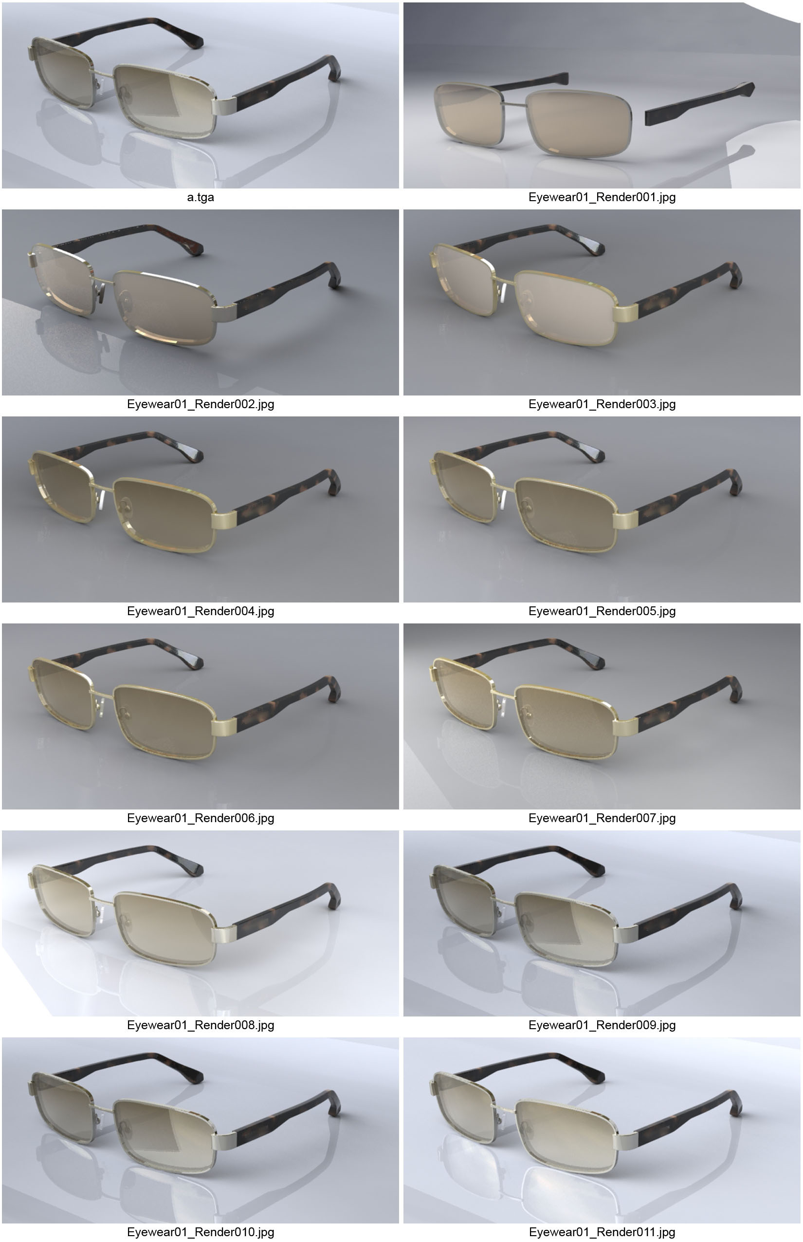

Eyewear is complex as hell to get right and modo’s been good to us thus far. I’m the only one (of 5) using it as we’re just getting into 3d. I’ve built metal/zyl combo frames (see attached images and modo file) w/ relative ease. I’m not super experienced in modo yet, but have been messing around and watching all manner of tutorial via the web since I heard about it. I finally have time now to focus on it since I think it’ll work for us here. These frames took about 6h start to finish, but I’m sure I could do 'em again in about 45 minutes if I was really hustling based on what I’ve learned. There are a few details missing, but nothing you could see in the render or would mean anything in a 3d print. The renders took about 35s each.
