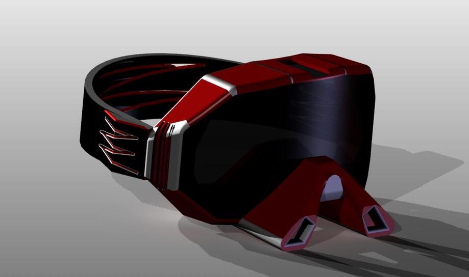

Hey thanks for your tips, I had a go at the goggles…what do you all think?
Also comments welcome about the designs themselves and not just the lack of CAD ability.
thanks a lot
If you want us to comment on the design, then show your sketches. Cus I don’t have many positive things to comment based on the rendering.
It would have been cool in the Star Wars era.
thanks for your input, do you have any tips on the rendering? It was done on photoworks…I find it hard to get correct lighting.
Well, I don’t have any experience with photoworks, so I can’t comment on the usage of software.
Generally, the model itself needs to have good surfacing to begin with, or else it doesn’t matter how good you are at lighting, the rendering will still look bad.
You really shouldn’t use back lighting if your intention isn’t to show the rear details.
how did you get on? what did they look like in the end?
take a look above…more block model then curvy
Well it is a start. You are learning the software, but you are approaching it from a too simple solid modelling approach. It looks like you did a bunch of cut extrudes and fillets on a base extrusion. Not a good method really. Think about lofts or sweeps when constructing a goggle.
Also start looking at the surfacing tuts that come with Solidworks.
I actually dont mind blockiness if it is intentional, but from your screen shots it really does look like the software drove the form.

Idea is great, And manufacturable but not functional.
Some of the sharp points of the nose piece are too close to flat edges.
It is important to think about the lifespan of the product. I can think of resins that will work, but be too expensive for the product.
Remember when your instructor told you to keep wall thickness as uniform as possible?
You will not specify the resin used in most cases. If you design a tiny radius in some spots the mold will fill better.
