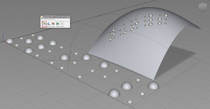

So, does anyone have a strategy for modeling braille dots on an organic form (think lava-lamp type blobs). I am making small sculptures for someone in cad, and they need to have lines of braille on them. The issue I see is projecting the braille (paths) onto a curved surface, as well as how to actually create the “dome”. Is this easier done in Rhino or Solidworks? Your feedback appreciated.

assuming the blob is NURBS, i would use the conform tool to place the Braille onto curved surfaces. This will atleast conform or place them directly on the surface and keep the spacing correct. cool thing about this way is that you can just slide the braille words/sentences over the surfaces and place them any where that you would like and the History allows you to adjust later.
Pretty sure there is something similar in Rhino but it might not be as interactive for placement…
hope that helps or gives you an idea.
in Rhino, Transform pull down / Flow along surface

For SolidWorks try using a sketch based pattern. Create a 2d layout sketch for spacing and then a 3d layout sketch that has the points constrained to the surface and 2d layout sketch.

Thanks dnikitiuk, this is how I ended up doing it - not the quickest method but it worked.
