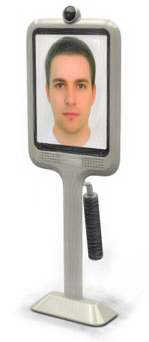

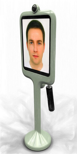

Here is generation two of a mobile telepresence concept. Thin, two sided placard shaped system that places the display at the height of a human face and allows a transportation from location to location or a physical inspection of a site.
Front view.
Rear view showing sketch of user interface with SteadiCam style pivot and handle.
The lower base allows placement on a desk or meeting table, can be deposited and left without operator continued attention. The location of the handle gives the same natural human stabilization as a SteadiCam mount to make life less nauseous for the remote tele-operator. Smooth video. The system uses a set of dual screens, one for the communication system and one screen on the reverse for operator instruction. Due to the requirements of instruction, an e-ink system would fit the requirements and have lower weight and energy usage. Chargeable through setting on a base. Camera allows for independent rotation by the remote operator.
Construction site tours, remote visitors to patients in hospitals or instututions (rentals), meetings, virtual factory tours for international business prospecting and quality control. More to come.
Adapted the base to similar language as the TeleFace placard, added the stereo speaker holes.
Defensive publication checklist.
  1. Dual screened, front and back telepresence mobile placard.
    Mobile wireless communication device for easy transportation, used as a remotely directed system for simulating presence in a distant, difficult environment.
Batteries and electronics are housing in the “foot” section to provide a counter balance to the top screen section and stabilize.
Pivoting handle allows the unit to self stabilize, as in Steadicam camera technology, to help eliminate sudden changes in the angles of the transmitted video which are disorienting to the remote viewer.
Swivel camera allows the remote user to alter the viewing angle independent of the main unit. An alternative would be to capture a full fisheye field of view and use software to focus on a visible section and “unwrap” the fisheye distortion.
Augmented reality possible in both displays. The rear side, used for guidance by the operator, can be overlaid with the known environment. The transmitted view can have local information, for example inside a factory, construction site, hospital, cholera epidemic site, etc, augmented into a layer over the live video stream.
The unit houses transmitter and receiver, GPS and directional sensors and electronics and systems required to run.
A web type interface would be used by the remote operator to direct the path of the TeleFace unit.
