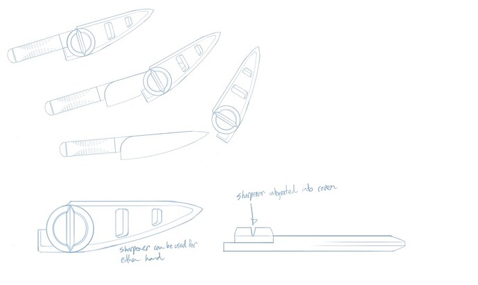

A sharpener is an essential tool for any knife to have. I wanted to try to integrate the sharpener into the knife somehow. I think this would be more convenient than having to look for a seperate sharpener. Another reason for pursuing this project, albeit a more selfish one, is that I move from place to place quite often, and the less stuff I have to keep track of the better. If my sharpener and knife were in one place, that would make it easier to keep track of these items at least. My target consumer would be a person who’s independent and enjoys cooking. When he or she cooks, it’s almost as if they’re reaffirming their independence. They don’t want to rely on eating out all the time, they want to enjoy a home cooked meal.
So two possible solutions I’m messing around with is the idea of a knife cover that doubles as a sharpener, or integrating the sharpener into the handle as a detachable unit. I like that the knife cover allows me more freedom in sculpting the handle, but I don’t like the idea of seperate pieces because it defeats my original intent. I like the detachable handle, but fear that I might be complicating the process.
I am in the very early ideation stages of this project so I want to get feedback so I don’t commit to early to an idea, only to find out later that it’s not feasible.

I would be leery of a knife handle that “comes off”. I like to know that I have control over what I am cutting, and the thought that the handle may come off of my 14" chef’s knife isn’t too comforting.

Aren’t you losing a lot of grip area from using the handle? Also with number 3, how are you going to sharpen the knife if the sharpener is at the end of the grip? Disconnecting the blade from the handle will have (dangerous) implications. In a wet environment, having a grip on blades is important.
I think a “Coring” idea might work though, where you unscrew the end cap and instead of the whole handle coming off or half of it coming off, only the core of the handle comes out. That way you still have a grip on both the knife and the sharpener.
Who keeps their knives in covers when they’re at home? Most people have knife blocks/magnetic thingies.
They already have this.
Google Wiltshire Staysharp. The cover is a sharpener. They are cheap knives so don’t work that well. I remember we had one in the 80’s.

  • The flaw I see with the sheath is that typically you need several strokes to sharpen the blade and one on the way in and one on the way out would most likely not suffice and would be more of a novelty product than truly functional/useful tool. If it did remove enough material to sharpen much you’d also end up with a collection of metal debris in the sheath.
  • I’d agree with Lew about being very skeptical of a handle that comes off, I’d hate for the value or perceived value of the product in it’s primary use model fall victim to an added feature. And also consider that knives are typically not single
    items, but families so this feature on one handle would most likely not lend its self to knife set designed from a systems approach.
  • Also note on the lowest image, that many of the ceramic sharperners have two steps for the sharpening process to help achieve the desired edge.
