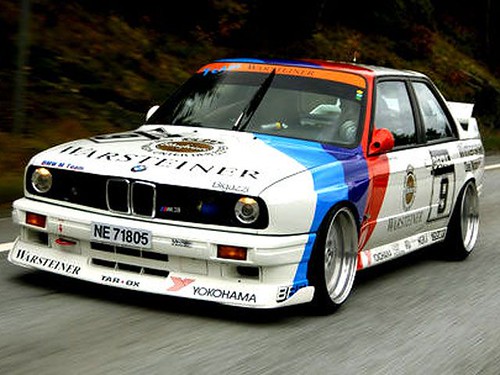

Take this rally car as another example. How could the coloured stripes as a single texture be placed on the object?
Car livery would be fairly easy to do pretty accurately with just some planar projections. You can adjust the aspect ratio of the projection to counteract any potential distortion on surface.
The stripes you could do as a single or multiple planar projections. If you did it as a single you’d probably want to find where their visual “normal” would be. IE if you were to look at the car, where would you have to look at it from to have the stripes all parallel to each other. If you projected from that angle, your stripes would cascade in the way you wanted. Otherwise you could just manually align 3 planar projections for each side and the roof.

Does this mean you’d have to split the texture into different sections before projecting them separately and aligning?
Nice to hear it’s not a prob, thanks. What software provides the best projection tools other than Maya?
You don’t necessarily have to split the texture- for something as simple as the 3 bands of color in Alias you could probably build it all as a shader or just 1 texture with the 3 bars of color and adjust the projections as such.

Take for example the M3 you posted. As it stands, the side graphics could pretty much all be applied with a single planar projection from the side.
Now imagine you’re doing this in real life with vinyl, and you want to put a detailed graphic in such a way that it overlaps the big fender bolsters. You’d have an issue - because from the side the top and bottom of the fender are almost next to each other, but the bolster would create a distortion where the vinyl/texture would have to stretch.
In that case, you would either need to move your decal OR somehow account for this by assigning the top of the bolster it’s own projection that lets the texture map more naturally on the top of that surface then the side projection would allow.
