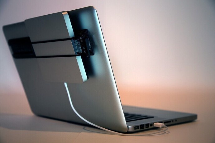

The LOKCLIP Rail
The rail has two roles: it is a simplified, minimal handle and a mounting base. Attaching a suitcase-like handle on the light and thin modern laptops for quick handling purposes would be excessively unnecessary and completely unfitting. Any laptop can easily fit in height between the thumb and the palm with the hand in a reaching pose but it can as easily slip out of the grip. The purpose of the rail is to provide the missing support for the index, middle and ring fingers to lodge into. The handling function is completely fulfilled by the rail alone. If the system is also used for mounting, then one or more LOKCLIP clips are required.
Technically, the rail is a custom I-beam. Its distinctive feature is the C-channel used for mounting and handling. The height of the flange together with that of the lip sections is sufficient for the clips to interlock with the rail and that is usually a fraction of an inch. The web section of the rail, or the distance between the two flanges is also very small, around one inch. Opposite to the mounting side is the bonding channel where the double sided adhesive tape used for attaching the rail to the laptop is placed.

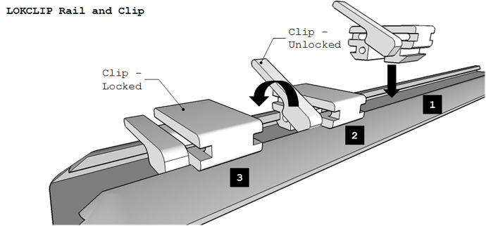

The LOKCLIP clip works in combination with the LOKCLIP rail to which it attaches to create an inseparable but removable snap joint. The snap fit and the lock are the two components of a LOKCLIP clip that guarantee the resiliency of the snap joint with the rail.
The LOKCLIP Rail and Clip Assembly
The mounting operation is entirely manual. An unlocked clip is squeezed and pushed into the mounting channel (1) until it snap locks (2). The clip is locked (3) to ensure that the snap joint does not separate under the effect of the various forces exerted in the mounting assembly. To remove the mount, these steps are reversed.

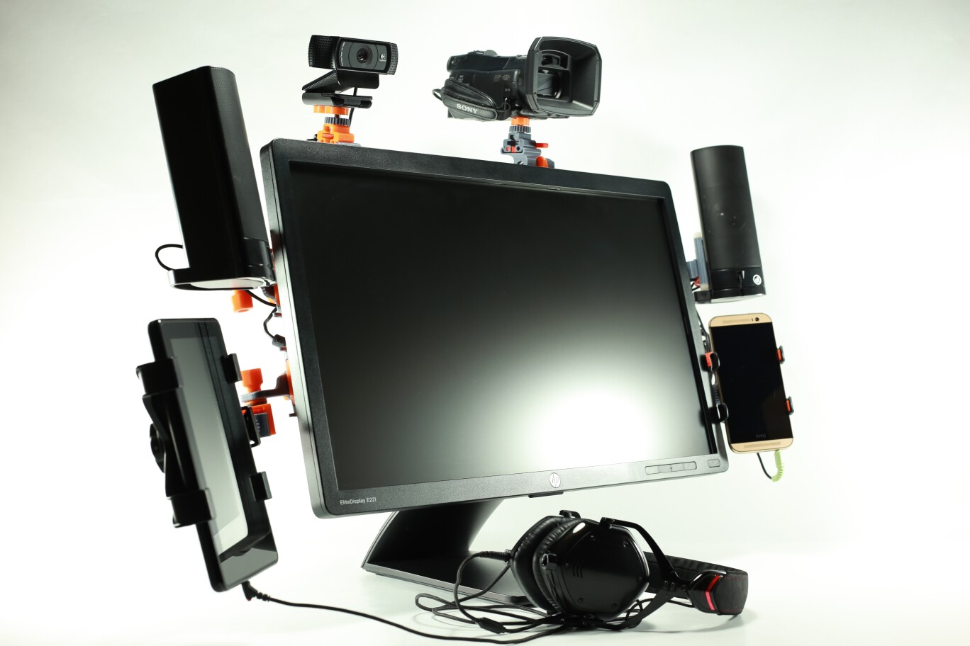

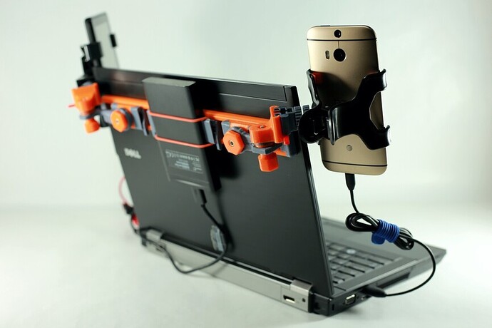

Hello, here is an update of my work.
Demo for monitor loading using CRAIL (Clip and RAIL) mounts.
This layout works well for gamers, those using standup desks, those listening to music on their phones while working, etc.
The same is easily applied to laptops, 3D printers (monitor your prints), and really anywhere you want to mount your multimedia devices quick and easy.
Except for the rails that remain attached (to the back of the monitor in this case), all other components are removable and reusable.
Laptop Mounts
Printer Mount
