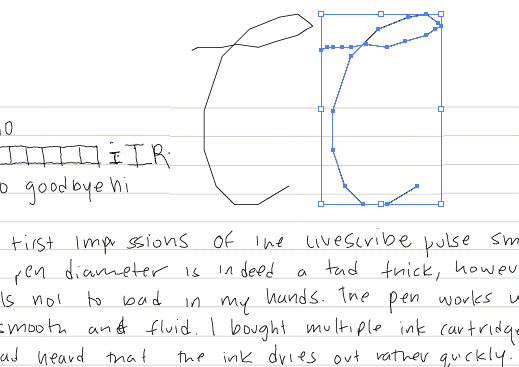

The software allows you to Print, Upload (to community site), Export, and Copy page. Print and Upload is self-explanatory. Export gives you two options, Export as PDF or as Image. Image gives you two options as well, with background or without. The background means the type of notepad you used. The software is able to recognize which type of pad you originally wrote one, for example, if you were to write in a college-ruled notebook the software will display your notes on a college ruled notebook. If you wrote on blank paper, same thing, the software will show you your notes on blank paper. When exporting as an Image, you have multiple save as types: .bmp, .jpg, .gif, .ico, .tiff, .emf, .wmf.
When saved as PDF, the file is 100% vector. I was able to individually click and move each letter in the video link above. However, I think this is what (Travismo) was referring to, the vectors have many nodes which create a rather complicated and blocky/edgy reproduction of your writing or drawing. Ill put up an image shot of what it looks like in a bit. And also try a sketch to see what it looks like.
In this picture, you are seeing the letter “e” in impressions. Scaled larger to show the individual nodes.
It looks like this might be capable of some very interesting things beyond the prescribed uses, but I don’t think this is going to do what I want it to do.
