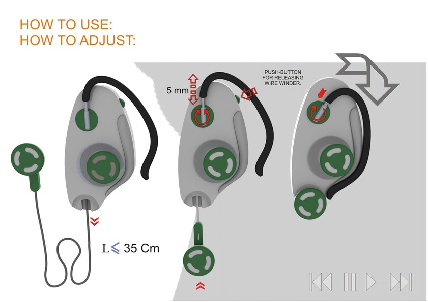

Hello guys :slight_smile:
Last year I worked on a concept about mp3 players and Aimed to get rid of the headphone wire which sometimes really bothers the user.
Recently I have been tempted to redesign 2 new versions of it based on different styles of Sony and apple with the hope to present the project to them although they are not so keen on unsolicited projects.
I would like to know your opinions and suggestions about it:
Inspiration
Listening to music while cycling or walking is one on my favorite activities, but current mp3 players with long wires has always been bothering me ”is wireless the only way to get rid of this long wires?” this question was the beginning of the project and brainstorming…
Lescord:
Lescord is a mp3 player which the player and its headphone has been integrated together in a compact way to facilitate using mp3 player by shortening headphone wire as much as possible.
Lescord mp3 player would be placed on one ear; it has one headphone integrated with the player body and another retractable headphone for the opposite ear.
It has not been proved that wireless technology has side-effects on our body, but if we can use a normal mp3 player with all advantages of wireless technology, there would not be any reason for splurging on wireless Mp3 players.
Development
Project began with idea of retractable headphones mounted on mp3 player’s body, in the next step to make the design more resilient, one of the headphones was fixed on the body and the other one got embraced by the body to be protected from probable damages caused by objects around it.
[vimeo]http://www.vimeo.com/15897486[/vimeo]
Also on youtube: Semi-wireless mp3 player - YouTube
I question the feasibility of this concept. Making one side bigger inevitably means more weight on one side, however negligible. My solution when I run is to clip my ipod nano to my waist, and run the cord through my shirt and through the neck hole, I don’t see how this would be a better solution.
This is all based on my initial glances, I’ll look at this in detail later.
I feel like the concept has been done before, what this would bring to the market would be only a more compact version of what is out there unless I’m missing something.
Sony W252
and other similar products, including headphones for the ipod and headphones with integrated mp3 players.
As for the current design, I would move the cord to the back of the neck in the renders. With the exception of the ipod earbuds, which have equal length from the stem of the cord, most people i know prefer to lead one cord around the back of the neck (doesn’t look as awkward). I’m not entirely convinced that that the mp3 player is comfortable, doesn’t really look like it anyways.
Sometimes when I have headphones/earbuds on, I like to have one side uncovered so I can still hear what is going on around me. It would seem like the second earbuds would be in the way if I only wanted to listen with one ear.
Last thing, i would also consider earbuds that go into the ear canal like the W252 above. Not only would it most likely improve sound quality, given that your concept is an audio player, but also help keep the device in place, putting less pressure on the clip and your outer ear. Ive had problems with similar earphones in the past where the clip starts irritating the ear after extended use.
@ shuphrk
you are right about weight and that’s one of the reasons i want to redesign it and make a smaller version. also as “Everybest” just said, if I use ear-buds would help the device to be kept firm on ear and put less pressure on outer ear… as you just admitted you have to deal with this wire; you have to clip your ipod to your waist, and run the cord through… personally i don’t consider it so user-friendly,though you may be comfortable with it…
Thank you for the comment
@ Everybest
Thank you for Detailed discussion it was really helpful … I have already seen and used Sony W series and I like them.
as you said the only advantage of this design is that is more compact and you can carry it easily in your pocket.
you are also right about render…I should have done that with the wire around the back of the neck it would seem better that way…though as you know it’s possible to use this mp3 as you prefer, in front or back of the neck.
