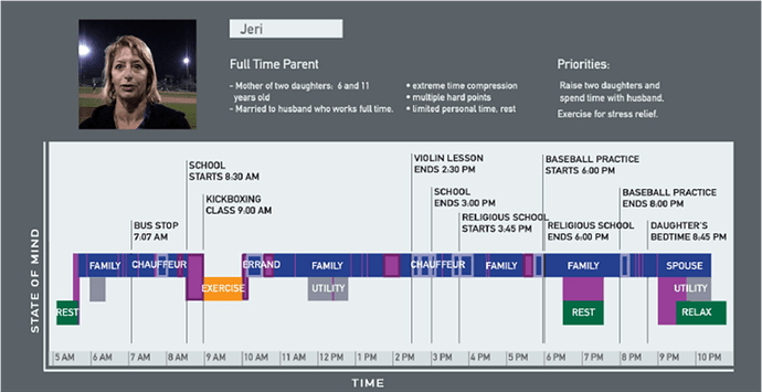

here’s a way to visualize one type of user research… ‘Mode Mapping’ as it’s called by SKD is a way of visualizing a user journey over a day. They had a DMI webcast on it last fall. They did this to call out opportunity areas where the design can be improved
I’ve seen this done in other ways for projects where it breaks down the user experience from approach to the product to when the user is finished and walk away from it
nice graphic. But I think the insights from that should be highlighted more.
I don’t think it matters in the presentation any persona definition facts (like has 2-3 kids) or raw data (like that chart). Data is useless without a context. In the case of research, the best way to present it is always to define your insights in a story or a scenario. Tell a concise story about a day in Jeri’s life, and focus on the points where you drew insights. A lot of students seem to think that showing charts and graphs means you can do research: it doesn’t. Design research is nothing without doing something with the data you collect. Analysis/synthesis is more important than how many users you talked to.
