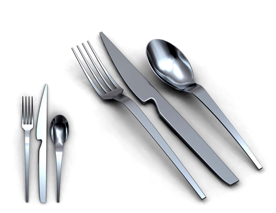

KnifeForkSpoon - Please crit me up
I’m working on finishing and compiling a project I started about a month ago. I’d like to hear anything you have to say. I’m just going to keep posting images.

concept3
Yes the transition areas proved to be the most challenging ( as they always are) I will revisit the tine proportions - this one to me was also the least interesting - i was thinking about throwing down some material or texture break ( see sketches above with green )
Yes, the knife is off. I have some ideas about how im going to bring it in, I’ll post when i make the changes. - and yeah - those surface continuity things are going to be the key as i tighten it up.
thank you so much for your detailed response. what do you think of 3?
mh, the concepts are hard to judge since cutlery is all about proportion, weight and maybe most of all, balance.
since we can’t "feel’ the models, I can’t really say which I like,
The first 2 concepts just look way to georg jensen, in my opinion. I responded positively towards concept 3 but am asking myself, where is the innovation?
what is the purpose of yet another set of cutlery that, no offense, looks like a lot like what is already out there?
maybe you can twist it a little more to make it stand out and give it more personality. Materials choice, added function…
I agree that I would need too feel it to really make a decision. As a food guy myself, I love to cook and entertain, but I would never buy a knife that I have not picked up and gotten a feel for.
On the other hand I do not agree that there is no innovation in concept 3. You have a very “stealth” like approach to the design which I think is very interesting. I think it is very contemporary with still a traditional look and feel. If I were to choose on looks alone I would chose concept three.
I do have to say thought that the form looks like it may be a bit uncomfortable when eating. Just something to think about.

some good work here, i like what is happening at the sketch stage where you are exploring many different forms and seeing how they match up. also, you show some 3d sketches with some interesting grip developments. i very much agree with idiot’s comments, i think refining some proportions, keeping commonality and maybe some surface breaks/textures could really help take the concepts further. concept 3 is getting closer to this. i like this contemporary and fluid style of the knife in concept 3 but i would be concerned about the weight/balance of the fork and spoon : mind that ‘belly’ proportion, it looks a little heavy.
bepster has some good points about innovation and added function(if that is an area that interests you…). for example, in your 3d sketches at the beginning, there are some interesting surface breaks on some the colour sketches, maybe these could me removable grips allowing different colour grip options. different grip options could also inspire the development of cutlery for older people or people who have arthritic hands with special grip needs. you have some dramatic form profiles in you concepts, especially on some of the spoon sketches, maybe this area could somehow be pivoted or bendable to customise the angle for the individual user’s eating experience…i dunno, just some random ideas…

cool, Concept 3 is my favorite so far
1 is okay, but safe
2 is a little georg jensen as bepster mentioned
But 3 is kinda new atleast to me in this category, some of
the angles may be a bit severe, but that may also be what kind
of excites me about it. I would probably stay away from two-tone, texture might be interesting. I’ve seen some cool stuff with bi-directional brush patterns as experimental finishes, but I would also say that Concept 3 already has a lot going on formally, so texture play may distract from the interesting forms.
I would always encourage you to try to find ways to innovate, but would warn against doing something that may end up a little on the gimmicky side.

So on concept 2 do you think if i changed that spoon up so the transition into the bowl wasn’t so wide it would have less of that 50’s look?..
I may just drop that one and only continue on 3… we’ll see…
yeah i hear what your saying here. I might just render some out in different materials\textures just to see what i think - i am afraid though about using color- or two tone like you said, with such an angular peice too… maybe for a set of children’s flatware… but this is meant to be sophisticated. again, i guess i’ll find out after i expirament.
yeah, totally, i didn’t want to make a spoon\coffee grinder here.
at this point i’ve narrowed the scope down and it dowsn’t include any functional innovations - however hopefully it will look and feel and work very well… thats the goal at least. thanks again for your help.
Concerning Concept 2, I think if you take the more angular approach of the fork and apply it to the spoon it would get you further away from the Jensen look, and/or narrow that transition as you mentioned.

I liked the idea of adding chamfer surface to flat surface which is prominately visible in knife (concept 3)…
But some more interpretation/exploration is required in this concept/style.
I belive that for this kind of product, design get justified at 3D level than sketching.
hope to see more…
