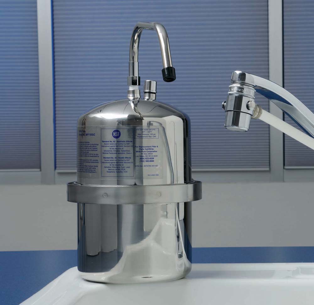

On thing that came to mind was a type of water filter I had at my house as a kid. It was designed so you didn’t have to permanently install a large/costly system (like the kitchen hot water systems). Instead it just screwed on to the faucet and had a simple bypass valve to operate it. It was not very aesthetically pleasing but it worked well, and was cheap and easy to install. I just thought there might be some potential there.
Dubya,
It’s no looker, but I can see how useful your suggestion would be. One of the problems with the small multiple kettle idea Yo and I were discussing is that whilst it would reduce weight, for my Gran it would also mean having to make multiple trips, which is a problem as she doesn’t walk well and uses one of those three wheeled walking trolleys to rest on. Currently her trolley doesn’t have a tray as she can make it narrower to get between furniture and so that it doesn’t take up a lot of space when not in use.
The water filter idea would solve the filling problem, and (with careful design) it should be possible to fill and pour through the same tube so the thing doesn’t end up looking like an Octopus. If I could get her to steam her vegetables, I’d then solve the problem of managing heavy pans full of boiling water. It’s a much better solution than what I started with.

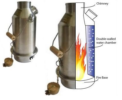

The Kelly Kettle, an 19th century product, refreshed. Granted, this is a camping product, but I like the concept. A water boiling system, with cooking vessel accessories. And, you could probably power a small locomotive with it :sunglasses:
