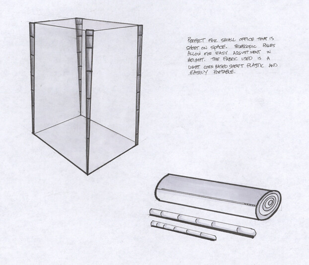

Here are some concepts I came up with for the redesign of a trash can for our first project this semester in studio.

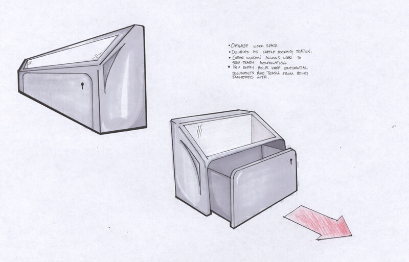

some more concepts

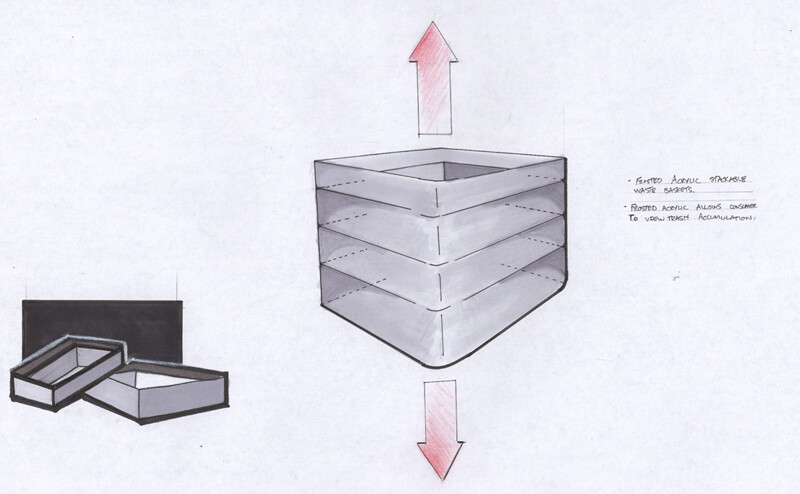

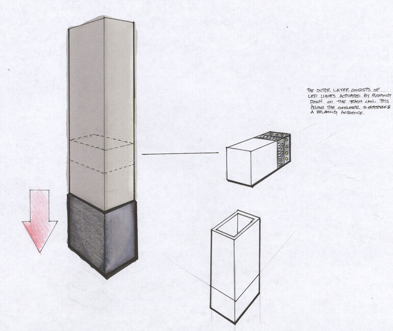

Here is my final layout for this project, thoughts?

Thanks for posting.
Your ability to share your stuff and get feedback will help you to get farther faster with these skills. A lot of it is learning how to see, and learning how to approach the page with confidence.
I recommend taking a break from the rigid constructions to try some more empathic sketching. Loose, from the gut, with more calligraphic line styles… then return to the constructed style and back an forth until they start to meet in the middle.
Keep doin’ it! Have fun!
The drawings are VERY static. Your forms are all just boxes with very rigid lines, and static composition.
Check out idsketching.com and print out some pages of sketches that inspire you. Buy the design-sketching book and take a look at all the different styles and what makes them good.
Good sketching is about communicating a good idea with enough looseness to convey some good emotion and style.
Practice drawing every day for at least 1-2 hours. Start off with the basic exercises (drawing straight lines, boxes, ellippses) to train yourself then practice drawing something from around the house. Start with things that are a little bit easier (simpler forms) and then work your way up to more complex and organic forms.
You need to learn to look at other peoples work and how to apply the skills and lessons to your own drawings. While the box is the foundation of just about every object, you need to learn how to start fleshing out form and surface within those boxes.
Loosen up! Thats what i got told when i posted work here for a critique and it made the world of difference to my sketching. Express the product through your sketching (this includes what drawing medium you choose)…
Hide your straightedge for the next two weeks.
the most interesting thing you’ve shown us is the can. I think this is because its a composit of more than one simple form… i.e. two cylinders kindof in a state of mitosis.
everything else however is basically just one simple form. try more composited stuff, you may end up with more interesting results.

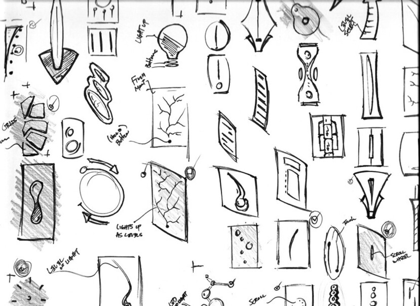

Here are some thumbnails of our next assignment. a light switch redesign…

any C+C is more than welcome
Draw bigger. Thumbnail doodles are fine for yourself, but you can only get so much detail and line weight in little drawings like that.
Theres so much good footwear design going on on this forum that you should have no problem finding good reference material for line weight and proportion.
