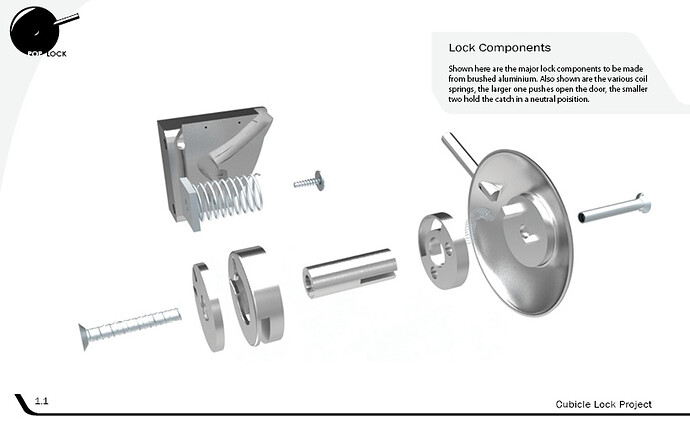

Hello I am James,
I’ve just finished my second year at university and am now about to apply for internships for the summer with my 2nd year portfolio. I would be very grateful for any feedback you could give me to let me know if I’m on the right track (or not).

I’ve re-read your last paragraph about the door project a few times, I am under the impression that you believe the door project is about the re-design of the main toilet ‘block’ entrance, but it is intended as a re-design of the individual toilet cubicle latches (or lock/indicator bolt). Perhaps I have not clearly shown the intention of this project?

Regarding the door project, I have re-read what I have written on the 1st page of the door project and It appears that I have explained the project incorrectly. As it currently reads, it would appear as if I am concerned with the germs on our hands after we immediately exit a cubicle, which are eliminated by hand washing anyway.
What it is meant to explain, is that I am concerned with the aspect that a typical cubicle lock is a forced interaction that we have to make when we lock the cubicle for the first time. Therefore we will be touching a psychologically ‘dirty’ and a likely physically ‘dirty’ component (yes some germ tests would appear to be a good addition to this project) and so spreading germs to ourselves and clothes. The proposed solution essentially keeps the germs on our hands to ourselves when we make the exit and the next person does not pick any up to spread onto themselves.
I thought that there may be some validity to this project as there are various designs for touchless flushes, touchless toilet roll despencers, automatic toilet seat lifters all concerned with reducing the spead of germs (and psychological perception of ‘dirtiness’) through forced hand-interaction.

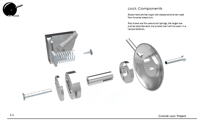

Hello Yo and tarngerine, thank you for your expert critique, I needed a kick up the rear to knock me out of the tunnel vision. I’ve attached a revised page scheme sample to show you that I have pared down the crud.
As for the quality of the images, renders and sketches I need to redo these but I am running out of time to apply for internships. So I shall attempt to redo at least some sketches/renders but I am going to have to make the most of what content I already have.

You still have residual graphics left… I honestly would get rid of them. What should separate your portfolio from others is your content and way of thinking, not your graphics!

I have pared the layout down to a minimal level. I didn’t realise how wrong my attempts were intially; I have alot to learn!
