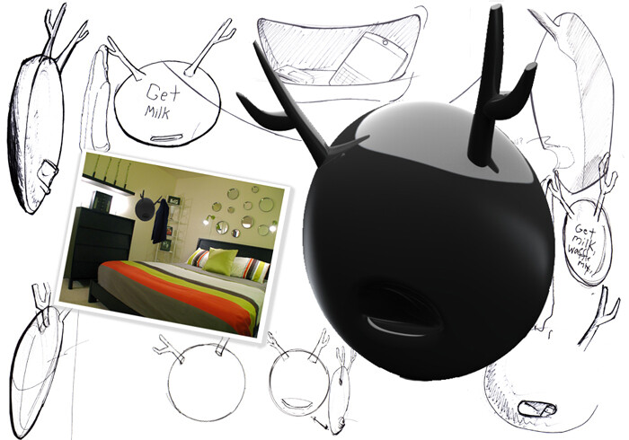

It's a chalkboard coat rack
This is a coat rack that has an opening to store a phone, mp3 player, wallet, whatever. There is no reason that a multi charger would not work in it, I just have not shown it here. There was not much process to this, it just sort of came to me. It is for nothing, other than personal practice. But I’d like to hear what you think.
It was told to me to incorporate a dry erase pen in the antlers (maybe two small points on the lower inside). One being a pen the other an eraser, why not.
what happens if it is writted on and then i put my black/white coat on ? wuoldn’t it stain my clothes???
I’d have to look at dry erase pens, I would think that staining cloth/ felt / leather has been accommodated for. If not buy a new coat!
It is a good point, I wanted to use chalk first, but that would show up on dark wool and other materials very well and very easily so no go on the chalk.

What problem is being solved? Who is the market?
Keep stuff that makes marks away from my clothes!
Far side of the bedroom seems like an odd place to put this. Not where I need to hang coats, not where I need to make notes.
All your sketches show the same thing?? Where’s the exploration?
What is the form/color all about? The mounted deer head reference is obvious (and trendy), but why is it a glossy black blob?
If charging devices, what about access? Does that mean a charge cord is going to hang down the wall?
I think you’ll be more successful if you focus on what you’re trying to deliver before you deliver it. I think a coat rack that charges mobile devices and can be written on has merit since these are all things associated with coming home/leaving the house. Start with that and show us your problem solving skills!
I think you have to communicate why people would want to have something they can hang coats on, write notes on and charge phones. To me it seems you just thought of 3 design problem area’s and combined them all into one. If my coat is hung up, the written note is hard to notice/can’t be seen… What’s the point?

according to the in room rendering, it looks like the coat hangs away from the chalk board.

Maybe this would change the overall appeal of the whole thing, but you can solve the risk of damaging clothing and the inconvenience of not being able to see the messages by moving the hooks to the bottom of the rack, so that garments will hang below the board rather than in front of it.
I think it’s the start of good idea. People come home from work, empty their pockets, phone, loose change, keys, then go to hang up their coat. But making it charge phones and you can write on it, just seems to be getting a bit feature heavy.

Needs simplifying I think.
