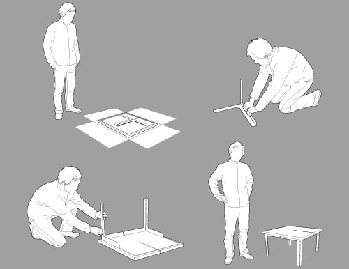

Wacom + Illustrator = great linework drawings for storyboards & scenarios illustrations.
You can adjust the sensitivity of the pencil tool to get a great vector-based set of lines and then play with stroke/line weight to reach the desired level of contrast.
Any examples NATE?
-J->
Something like this…

-Thanks Nate!
r*
Looks great! If your sketching, where do all the extra lines go? It seems this might work with a sketch scanned in as a template but to actually sketch with a pencil in Illustrator seems alien to me.

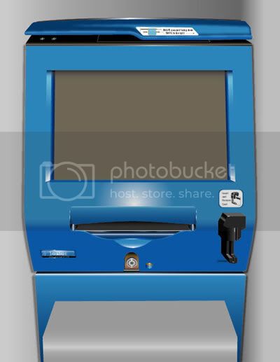

Nice shoe renders! I use illustrator but I can’t see how anyone can use it to sketch. I tried and came up with garbage.
Here are a couple things I did in AI though using the pen tool and a mouse.
-J->
