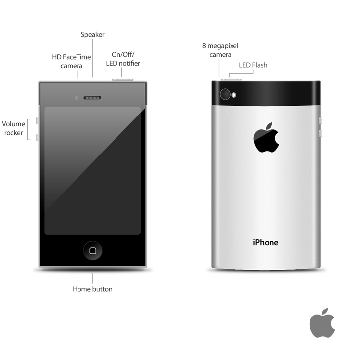

Hey everyone, nice to meet you. I’m an aspiring graphic artist and industrial designer. I know my work isn’t the best out there (I’m no Andrew Kim) but I thought I’d post what I’ve been working on. But first, a short bio!

This is the concept: edge to edge strengthened glass, textured aluminum on the rear with a back poly-caobonate band that runs around the top for the antenna (no more “antennagate”!), and upgraded 8 megapixel camera with an LED flash. The front also sports a new HD FaceTime camera with 720p recording. I also loathe the lack of a LED notifier, it’s one of the things I miss from my Droid Eris. So, the way to fix this without sacrificing design of functionality is to micro-perferate the On/Off switch and place an LED light inside it (sort of the same concept of the MacBook Pro’s LED notifier).

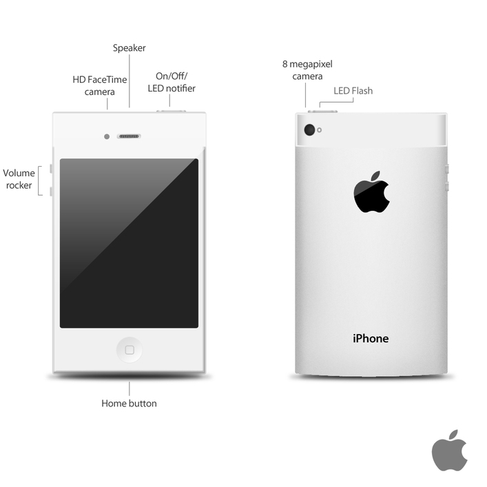

Here it is in white.
This is the top and bottom. I wanted to figure out a way to add another speaker for stereoscopic sound, so, given the extra space on top, another speaker could theoretically be placed there. This design would also would slim the iPhone down to a mere 6.5mm thin, making it one of the thinest phones out there.
I know my skills are pretty mediocre at best, but I’d love to know your thoughts. I’ve got a lot to learn, so please, any tips, criticism, or suggestions are appreciated.
I wouldn’t worry about the skills (I mean a little, always room to improve, but you are showing the idea and that is the point.
A few things to think about:
  1. most phones have multiple antennas, and they can’t be stacked and may have to be on opposite ends of the phone for reception… having the plastic on one end does not solve for the antenna transparency issue, you may ant to adjust or have bands at both ends.
  2. our of curiosity, why no 3d camera?
  3. the aspect ratio of the screen seems different? Is that so and if so why?
  4. in the top and bottom views the glass seems to be flush, but in the front view it seems to go to the edge. It would be at minimum .5mm thick, the current iPhone’s is 1mm I believe…
  5. the bak pannel has a nice curvature which I like a lot, and is a complaint about the current phone, of course it will make it thicker by maybe 1mm… but not my point. It would feel more resolved if the top view details responded to this curvature in some way.
Thanks for your thoughts, Yo.
  1. I never thought of that, although the first iPhone had a something similar situated on the bottom half of the phone…
  2. 3D isn’t really a mainstream technology, and would mean changing the screen and OS to 3D, adding a 3D slider for adjusting the effect, and adding another camera to the back (more $$$) - although, it would be pretty sweet to have them!
  3. It’s probably off, that’s what I get for estimating…
  4. The black strip on the back would meet flush with the screen on the front, the rest of the screen would be bordered by the back casing. I’ll try to fix that in my revision…
  5. Furthermore solidifying the lack of my skills. :laughing: I’ll try to fix that as well.

I see now in the front view how the glass is offset a bit. If the top is plastic, should,t it be black?
Yes, the iPhone1 only had plastic on the bottom, but the technology has changed, phones have more antennas now.
The screen is arguably the most important part, measure it to get it right.
Edited it a bit, hopefully that makes it clearer. I measured out an exact 4:3 ratio for the screen and fixed the boarder. And adjusted the shading on the back… And thanks again for your help. :smiley:

also, I don’t see the volume buttons in the top and bottom views, and I’m sure I should according to the front and back views. They seem to protrude more in the front view than they do in the back view… a side view should really be shown to understand them, according to the back view they look pill shaped.

Yo and Tarn raise some good points. I think it’s a nice sketch overall. The top and bottom corners seem a little sharp.
If you want to push this concept further, definitely measure a screen and print everything 1:1. At cell phone scale, the details need to be considered down to 0.10mm. For instance, try measuring the chamfer on the speaker slot of an iPhone 4.
I was hoping you would weigh in Brett! Definitely print 1:1… also, if you want to get a sense of those corners in your pocket, cut a piece of sheet metal out at that size with the same radii… now put it in your pocket… I guarantee you it will convince you to increase the radii :wink:
Interesting how the radii on the blackout area around the screen does not respond to the radii on the outer form yet… it can and should.

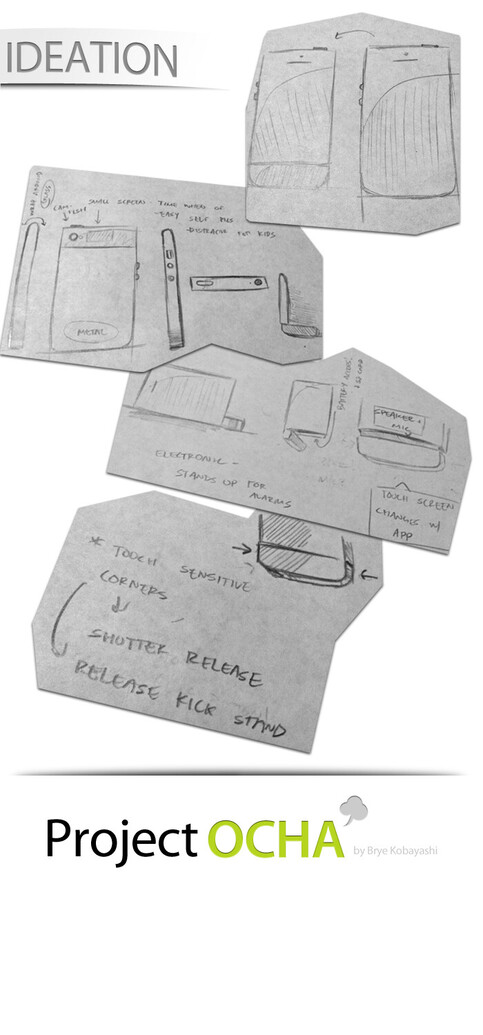

This would sort of be like my dream iPhone. I couldn’t really stray too far away from Apple’s design “philosophy”, so I tried to improve it a bit. The band would come all the way up to the cover and back glass, as the iPhone 4’s glass jets out a bit from the band. I also imagined using the liquid metal to keep it structurally stronger. Here are a few more ideas to put up there:
    • Pressure/touch sensitive corners for enhanced gaming and gesture functionality
  • Extend touch area of front cover glass to edges - more gestures and functionality
  • Using that “paper battery” concept to give more space inside
  • Induction charging (that’s why I excluded the 30 pin dock connector) and a multi-functional charging stand (alarm clock mode, etc.) - Since the whole iCloud thing will probably happen, syncing can be done wirelessly, and an adaptor could be used for 3rd party accessories
  • NFC - extend it’s usefulness to send music, video, interact with other devices, notify of discounts at stores, etc.
  • Add on an anti-glare (the type for glasses, I know it exists) and hydrophobic coating to the front and back glass - easy cleaning
  • There’s some sort of second generation IPS tech that LG or someone created, that could be useful
  • Memory glass alloy (with some sort of rubber base) that prevents scratches
For now, that’s all I got. :laughing:
