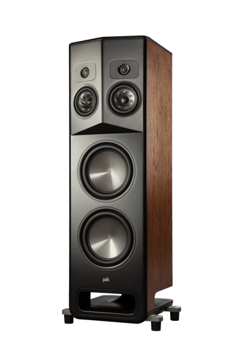

nice accentuations of the lower drivers. Where those powered woofers, radiators, or connected to the amp? (sorry, nerdy question) …

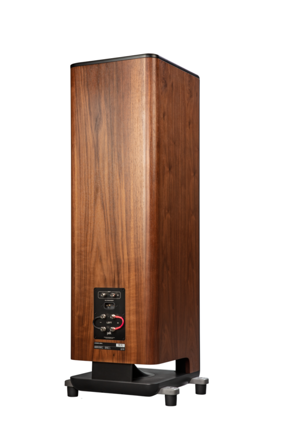

I love having a set of these in my living room :slight_smile: Bi-pole front and retiring midrange and tweeters, lower side firing powered subwoofer woofer and dual side firing bass radiators … they crank. So they have drivers on 4 sides, but you can’t see them. No option to remove the grilles… basically it is an MDF box with some milled chamfers and CNCing with CNC aluminum top and cast base… pretty efficient construction.
I seem to recall the woofers had their own power…yes, according to an old spec sheet they had 300W for the dual 10" woofers. They weighed 100lbs apiece! Funny to recall that the tweeter plate height was driven mainly by the requirement of being in-line with the ear holes of some crusty audiophile sitting in his listening chair. Though the sub Hz isn’t directional, these crusty dudes were all about the ‘true’ stereo experience…plus I think Snell wanted to show off more woodwork, which built on a great New England heritage of cabinetry, yadda yadda yadda.
that sounds about right :slight_smile: Though what those guys can hear is pretty amazing. I really loved working with those guys. They taught me so much. This was one of the last systems I touched while at SU. Very cool phase array that actually used noise cancellation tech but in the room to push sounds outward. The ridges in the midrange drivers allowed us to use a thinner material while still maintaining rigidity… low weight + high rigidity equals better reproduction (faster movement of the cone)… The downward firing port pushed long bass waves out in a radial fashion. That little Hershey’s kiss shape in there did a lot of work actually… it takes a lot of wiring to set these up. You need to run left channel cables to the right speaker and vice versa in addition to the usual beaming so you are talking 3 sets of cables going to each speaker… and if you add the ATMOS module its another set. But it is fun to design for these enthusiast users sometimes.
