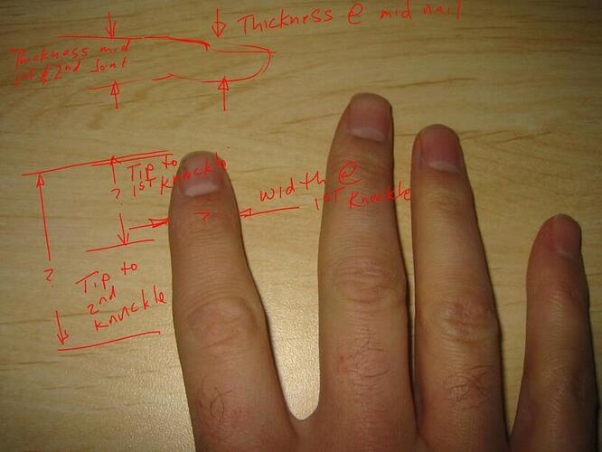

I need to design a rigid finger mounted device that is flexible enough to fit all sizes of fingers. It fits onto the tip of one’s finger. I have looked in the Human Factors Design Standard and found very general dimensions surrounding the hand and virtually zero information on fingers.
Two part question:
  1. Is there such a document I can obtain, purchase or otherwise, that speaks to the variable sizes of the human index finger? You can see on the attached photo what dims I am looking for.
  2. If there is NOT such a document…can you grab a set of calipers and measure the spots I am looking at getting and posting them on the board here?
I would be eternally grateful for assistance with EITHER of the above so I can start getting some kind of cross section data.

  1. If there is NOT such a document…can you grab a set of calipers and measure the spots I am looking at getting and posting them on the board here?
A. Thickness mid 1st 7 2nd joint = 70mm
B. Thickness @ mid fingernail = 64.5mm
Both of the above are dependant on how much the index finger is ‘squished’.
C = Length to first knuckle 26mm
D = Length to second knuckle 50mm
Unless open ended (an index finger tube), you will have to consider varying fingernail length.

Are you SURE about those numbers?
I have attached the data from Dreyfuss which has some but not all of the measurements you are looking for.
BTW, I have done lots of work in fitting products to hands, fingers and other body parts if you want to collaborate…
bb
ip_wirelessly, you’re right, thanks for pointing that out. Apparently, I’m not so ambidextrous, when using my old caliper with my left hand.
A. Thickness mid 1st & 2nd joint = 10mm
B. Thickness @ mid fingernail = 11mm

Thanks for the offer for collaboration. Not sure how it would work, especially based the timeline I am needing to hit. Just getting me these numbers has helped me tremendously. I am going to invest in this book for future reference. I always meant to, but never had a real reason to until this project.
As it turns out, I was correct in my assessment of my own fingers, I am a hair shy of the 50th percentile.
