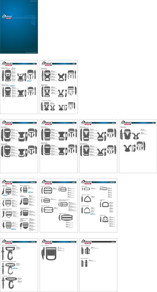

I know this thread is ancient, but if you still need some vectored duraflex buckels shoot me an email. I would just upload the .ai or a PDF but the board won’t let me.
