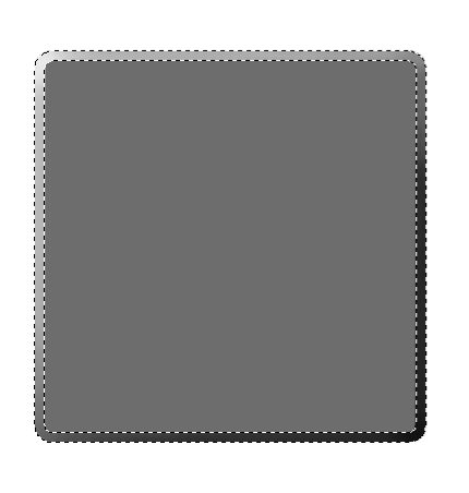

now we havent unselected the shape of the grey rectangle…so we are going to do the right click (PC) ctrl click (mac) on the path layer when we select the inner path with the path selection tool. we will subtract from selection here.

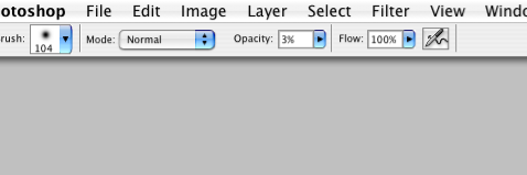

i use white and black to add shaddow/highlight, but I would use a darker red and lighter red if rendering red for example. i dont like black and white on colors becasue i think it muddies the render up. gross. i think it is important to use white and black (or darker red and lighter red) with the opacity down way low…here i am showing 3%…to really build the shaddow. i think this creates a really clean look.

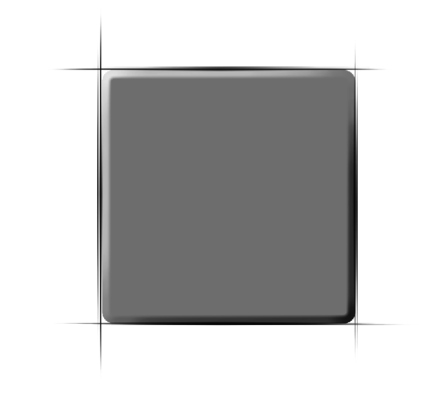

but because when i did the “subtract from selection” and kept the feather at 0 the edges are really hard…so what if this is a lycra or something…just type in a value for the feather option.
and using the same painting technique…i have really nice soft edges…all depends on the design intent of course…
i added some sketch lines just for the heck of it.

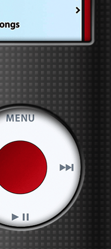

here is an image with the paths on top of a finished render. you can imagine how each selection was made, then filled, then rendered all by making a selection then subtracting away a shape inside of it.
a detail shot. you can see i have added a strong highlight around the bottom right of the scroll wheel.
