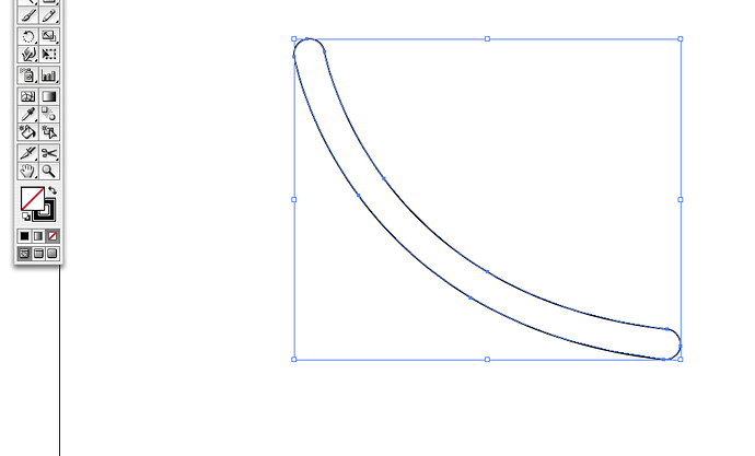

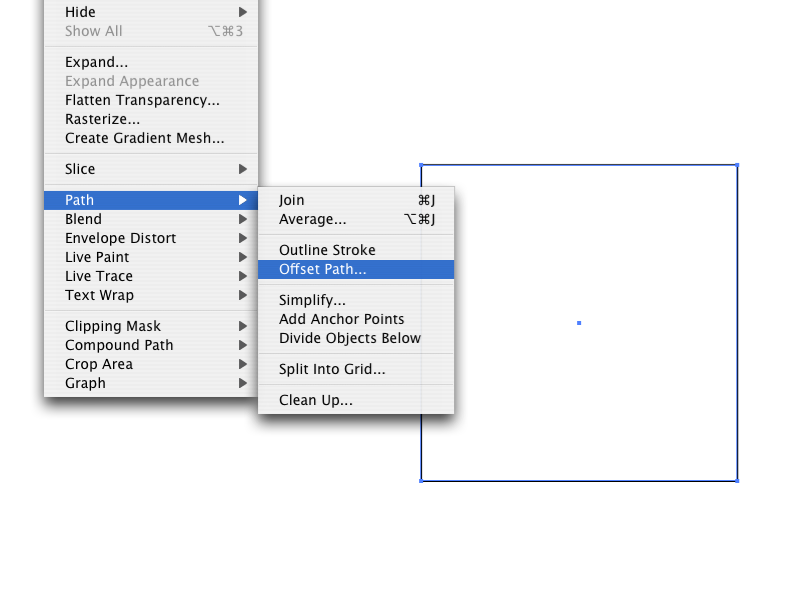

alright…ill start by showing two techniques i use quite a bit in illustrator to create line art…
offset path
and offset stroke
both are under object/offset
with the square selected, we can perfectly offset it.
and we can decide how thick the offset is (this will be the chamfer or edge thickness)

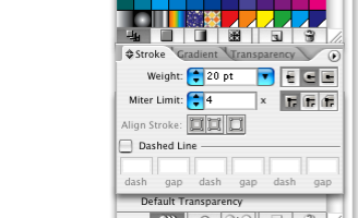

next i will show the outline stroke feature…
so if you make this stroke…maybe it is a cool piping that will be running the length of the shoe.
you can round ends using the stroke options.
then you can OBJECT/PATH/OUTLINE STROKE.
and it will be a filled shape rather than a solid stroke. imagine using this to make a selection in photoshop…this will make a bit more sense later.
you can reverse the fill so when working in illustrator you will have an outline of the shape.

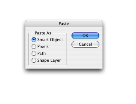

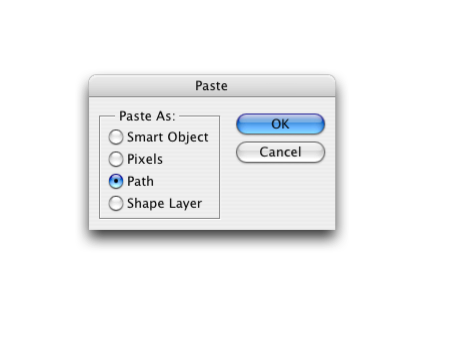

i have created a rounded square…and offset it inward so i will be able to render my chamfer in ps. imagine if this is a bunch of shapes of a shoe and you have created a huge awesome design with all these different parts…ok run on sentance…well…this is just a very simplified tutorial of how i render.
now i copy these lines and go to photoshop and paste. it will ask me…chose paths. this will allow your illustrator linework to be “selectable.”
