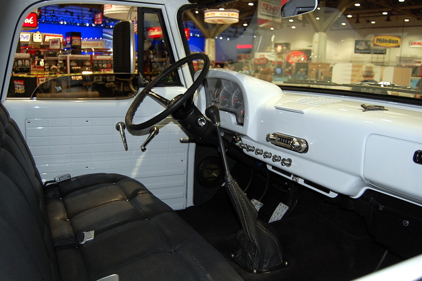

Now that’s cool. Love the gauges!

a few shots from SEMA

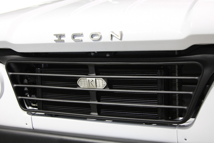

That front grill (grille?) design is sweet lookin!

Also, I’m obsessed with the name plate/badge letters on the hood of the Dodge. Plumbing the face of those letters is such an amazing detail, for a guy who makes letters all day…
