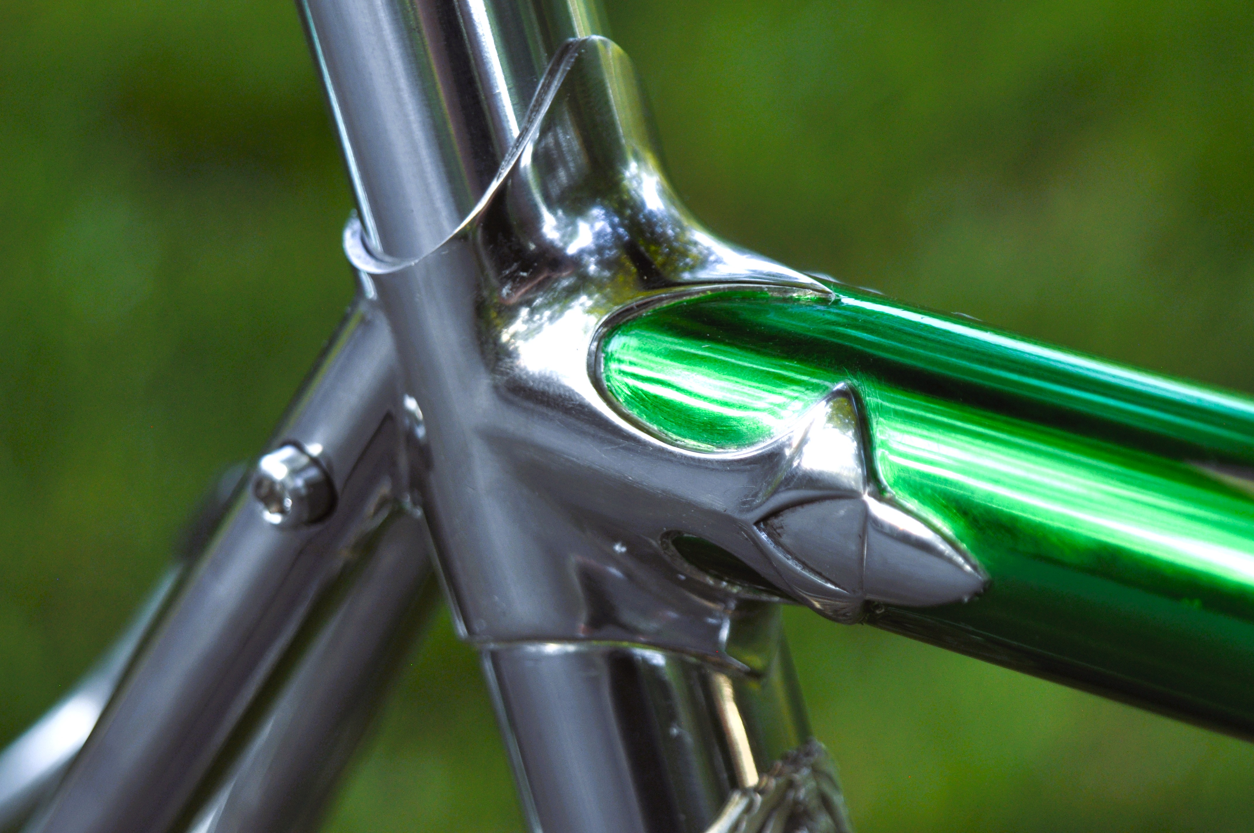

Well, actually two, but more on that later. It started 10 years ago, I may have mentioned it here, but my search-foo found nothing. At the time, while I was getting the most miles on my commuter, about 100+ miles per week, it was my worst bike. Aluminum frame, cheap fender, cheap rack, cheap pannier. Don’t get me wrong, it is standard practice to have a cheap commuter. You bang it up, it is exposed to the elements and thievery. But if I’m riding it the most, shouldn’t it be teh best bike?
So i have a thing for Italian bikes. Everything about them, so this is my tribute to all things Italian bikes. From the 1930s to the mid-60s, they mad what is called a Sport bike. All of the major Italian makers made them. Technically, the first hybrid, a cross between city bikes and road bikes. By the 50s, they introduced condorino bars. The problem is, to paraphrase henry Ford, you could have it in any size you wanted, as long as it is a 55. I suspect because it to reduce manufacturing costs, and it fit most Italians, not the tallest nationality (these bikes were for their market, never exported). Too small for me :frowning: .
While chrome is not exclusively an Italian thing, I do like shiny. I won’t do chrome, it is not environmentally friendly, so polished stainless was obvious. And no worries about rust. They did have cromoveltato paint, translucent paint on chrome. Chipped horribly back in the day, but the clear primer available today binds much better to polished metal. Fiamme (flame) paint graphics. They would bolt on a lucchetto (lock) to the seat stays, I integrated it as the “brake bridge”. Internally routed brake cables. Fleur di lis lugs were a thing from a manufacturer called Gloria. Maino made a triple-plate fork crown. Cinelli has the seat stay seat pot binder. The hubs are custom made, based on Ercole Baldini’s hubs used for his hour record in the 50s. Branded pedals and stems were a thing in the 40s/50s. Tiered fenders. Bone hand grips. The cranks are vintage with what is called a Gloria ring. Saddle is Brooks, while English back in the day, the C15 on the bike was made in Italy.
This is the inspiration.
This is the bike.
A few more pics.

Stem, levers and hub flanges are custom milled. Lugs, dropouts, fork crown, stay bridges and wrench are printed stainless. Pedal plates are laser cut. Bags were sewn on a Juki with printed mounting hardware.

The Italians had 100% internal rod brakes, that’s right, rod brakes, by the early 1920s. Why they never had internally routed cables for condorino bars is beyond me. All of them are like the example I posted in the inspiration pics. Seemed obvious to me to rout the cables like I did. Also, I don’t think internal cables would cost more in production.

I considered 114 spacing to have an even dish, but I decided on 120 in case I want to throw on a 5 speed sometime in the future. I doubt it, but not a big thing either.
Yes, a flip-flop hub and will do wicked skids. :winking_face_with_tongue:
I thought a curved rack would be nice instead of straight, then double duties to hold the fender. Since the bags were always going to be custom, attachment was not a concern. Its 12mm stainless, stiff as hell.
