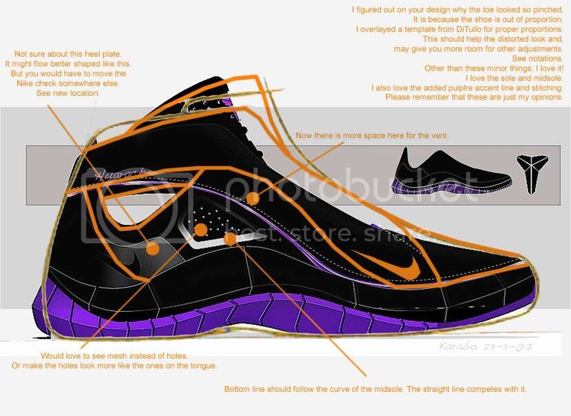

This is what i came up with after a couple of sketches and researches on the Huarache and after all the feedbacks that i received yesterday and today. I for the most part wanted to keep the feeling of all the huarache that have been done lately by nike. I really like the sole of the 2k4 it’s one of my favorite, and i wanted to keep that feeling. That’s what i tried to do on my second design ( the one i posted today) but…there was a couple of parts that did’nt work. So After all the feebacks i went back and redesign it.This time i think i’m on the right track but if no please let me know so that i can go back to work on it.
(Thank you all for your time and feedbacks)

Hey man. I love the new revision. Great progress! I am sending you an image of your design with some adjustments that may need to be made. Please forgive the quality. I am using a basic art program at work to produce the image and didn’t really want to spend that much time on it. The main revision to pay attention to is the proportions. The others are just minor ideas.
Paul Boucher

Loving the new design. Awesome, It might be a touch sleeker than it would be in real life, but it looks hot. I would not change it!!!
That template I did is a little chunky, I should revise it a bit.
I agree that the bottom surface of the vent fights with top line of the midsole a bit, good call out DP, but still your good. I think you are fine with the exposed heel counter with the subtle SWOOSH.

DP,
I must disagree with your suggestions, your lines seams to take this way far from reality. the current design is more realistic ( even tough it can get better)
some of your comments are personal prefferences, don’t let it influence the feedback you give… you don’t want executors to work with you but great designers!
dd.
DD - Yes some of my opinions are just personal preference, like the mesh compared to the holes, but it is also good to try different things, and it may have been something that he might not have thought about. But my personal prefernece comes from performance standpoint, where I feel that mesh allows for more ventilation than perforated leather. Also, stating that the vent shape conflicts with the arc of the midsole is not a personal preference, but a design critique. And the proporitons them self came from Michael DiTullo, even though he said that it was a little chuncky, I still feel that the toe box is too flat, not a personal opinion, but once again a design critique.
Also, I don’t think that you should take opinion out of design critiques, because things left unsaid will never be considered and you may miss out on something you might have never thought about. I also think that it allows you to sometimes step back from an analytical designer and let yourself think as a consumer giving you both points of view. But once again this is just my opinion.
PB
