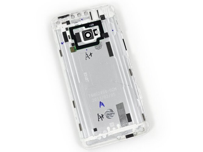

What seems pretty amazing about this if you’ve seen the phone & watch the video (plus look at some of the images on their site) it seems like they are CNCing the first part which actually becomes the “tool”, they then injection mold the plastic, and then machine away the rest of the part which lets them get the perfectly seamless construction with no shutoffs or reveals.

While you may not be impressed by the video, the actual process for constructing that bottom housing is very impressive. It is not a purely CNC’ed part, it’s a combination of tool making, injection molding, and CNCing all in one. I was trying to find the original process images I saw and can’t for the life of me track them down on Google anymore.
The fact that they’ve seamlessly integrated the metal, plastic, and antennas into one part is very impressive - and if you’ve seen the part in person it’s even more impressive than the iPhone 5 at a hardware level.
Hearing this description, I need to have a closer look at the tear down of this phone. Everything you’re saying is the stuff that in 99.9% of companies building something new, the engineers would say “can’t be done”.

If anyone has any better luck finding those process images (I thought they were on HTC’s site but theres so many criss-crossed links on the blogosphere I can’t find it anymore) they give some pretty interesting hints.
I’m guessing it’s an extremely expensive part, but since it forms the entire housing and they can recover the aluminum scrap, it works out. Plus making a million of them a month probably doesn’t hurt.
