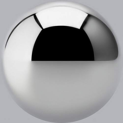

Like IP said its all about the environment… with that said there are a ton of emaps on the net that people have done to get the look you are going for. Environmental Maps are high res Jpegs of an environment, I have found that a studio image is perfect for crisp clean reflections, see image…

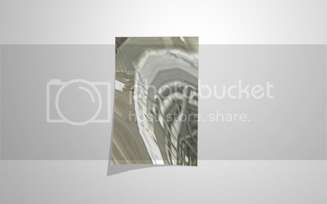

This is the picture I used.
Just to make things clear; the mirrors are curved, not flat…

Instead of setting your environment to be that reflective map, try building a half sphere behind your camera and applying that environment map to it. Also your mirror should probably be a single surface, not a clear surface over a silver surface.
From how it looks in the screenshot you’ve posted it seems your mirror is reflecting such a small portion of your environment map that there isn’t enough pixel data on the map to cleanly reflect.
Is there a reason you’re using that building for your environment? Creating some stand in geometry for your environment may be a better way to get some higher quality reflections, either that or a much higher res/sharper (that image you posted is high res, but not very high quality) map.

Your reflection map is plenty hi-rez, and it’s clearly not zooming into a tiny area of it. I think Flamingo just isn’t ray-tracing it with enough fidelity.
Most of the other suggestions in this thread are hacks, and they’ll make your life tougher if you need additional renderings out of this scene.
Mirrors are a nightmare, even in photography. And Flamingo contributes, despite what others say. The quality of the reflection is really bad. I tried slowest antialiasing, smooth & slower meshes, tolerance, no blurry reflections, reflection bounces, …
