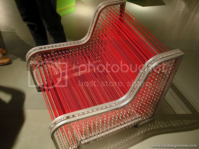

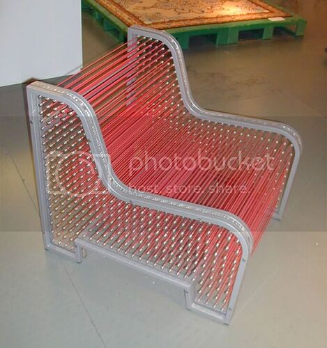

How could they have attached the cords?

The chair is laser cut acrylic (sandwiched between two aluminum frames) and the elastic bands are probably tied off or finshed in some way so that they are larger at the each ends. I could see this assembled with the bands threaded through the opposite plates flush together first, tied/finished off at each end and then stretched out and the middle stretcher bars installed. Can’t see what’s going on in the picture very well, though.

My main concern is to find a nice way to tie/finish off ropes.
Problems with the above are;
  • When squeezed their various orientations would turn it into a chaos.
  • For some the diameter is too big to place ropes next to each other.
  • Some are not wide enough to have sufficient friction.
  • Cords will sag over time.

Clear plastic - rope chair:
laser drilling of decorative plastics is rare and not recommended. The laser depolymerizes the plastic and will produce a surface that over indeterminate time (weeks - months) will craze and crack. Also, any swarf produced inside the hole is labour intensive to deburr.
The part is most likely drilled to get all the rope holes. The milling machine setup to drill could easily also counterbore or countersink these holes to fit a rope thimble or ferrule.
thanks for the info, I know that laser cutting plastics like nylon/hdpe doesn’t work too well, but I didn’t know acryilc had these issues. In that case a cnc mill could easily create these.

Without some sort of adjustable tensioning, that chair will sag over time.
It would also be difficult to ensure they’re all tensioned to the same degree.
With the chair any use of crimps etc on shock-cord will lead to premature failure. Looks to me that the holes are counter-sunk and the shock-cord is knotted off with, of course, the knot sinking out of sight. There are scores of knots that are perfect for that purpose and even some really inventive machinery that can tie them.
I found a better picture and it seems they used metal bits.
I still wouldn’t know where to get them though…
Buy them? You’re a designer… . . design them, and make them yourself.
Wouldn’t that be a waste of money if they can be bought?
I’m also looking into solutions without bits at the moment.
That would depend upon how unique you want your product to be considered.
You are more than likely looking at a screw-machined part; the cost to produce them should not be prohibitive; you would have complete control (finish, color, etc.) over the piece, and your source would be guaranteed.
I would design for “machined” parts for prototypes and low-volume production, but keep in mind that details friendly to injection-molded “plastic” would be the most economical for long run production.
how about ball fittings?
http://www.gbgindustries.com/StandardHardware.htm
Thanks, I also got this tip (p26 top + bolt) which allows the cords to be tightened with a bolt, the “elastic chair” on the other hand might suffer from sag with normal cords. But clamping several individual cords usually results in squeezed sections with different orientations.
So I’m planning to loop the cord using a combination of a few countersunk end stops (p61 bottom) and U-bolts + countersunk sleeve nuts;
So far I only found countersunk sleeve nuts at Stainless Fixtures and Fittings - Anzor Fasteners New Zealand, but the above is more like an M3.

Do a google for “s e x bolts” and related hardware … no kidding, that is the real name for them; sometimes called a “barrel bolt”. Another similar fastener is called a “binder post(s) & screw(s)”; you see them on some hardback document covers.
The above happen to be “tamper-proof” (note one-way ramp on head, and the stud in the center that prevents access with other than a special wrench).
Different configurations are available, and either side is usually available separately.
Here’s the ThomasRegister page for them; http://www.thomasnet.com/products/sex-bolts-6700447-1.html
