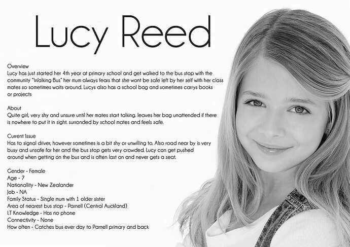

I couldn’t get beyond your cliche personas.

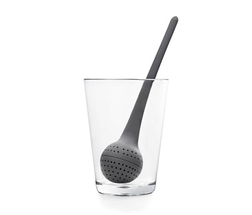

Your tea project looks a lot like this one.

I actually don’t think the group ended up designing anything so what you see in the pics is that Tea Egg product frpm NormannCopenhagen and it wasn’t the OPs intention to pass it off as their concept.
Might be wrong though…

Could you give me an example of a portfolio with stronger personas? Or perhaps let me know what you like to see in personas that make them less cliche?
Yes, the project is ongoing. That tea infuser is beautiful.
Personas are an amalgamation of data derived from several people. You didn’t speak with anyone. You made that crap up.
“We don’t have enough space in our tiny kitchen for a bunch of fancy accessories.”
“I eat a PB&J when doing crazy stuff.”
“I graduated and ride a bike everywhere.”
Seriously???
Actually talk to people about the project. Get their input. Do the research. Record what they say. Use that data to create a persona. Do the work. Don’t make up data. Don’t have the data be a reflection of yourself. It is not credible.
iab +1
Fluff is fluff and if your design is based of of fluff then it will show, if you show those personas in a interview and you truly made them up or only talked to 3 people and that was all the information you gathered then it will show a lack of understand on how to create personas that allow you to design for the stake holders.
Now you cant always interview 100 people (like just did in order to create 3 persona groups) but you should be able to dive deeper to better understand the individual or group
- Data on who the person is and how they fit into your demographic
- there current situation
- the problems they experience for the current situation
then your concept development should ba loop process, i.e you print out those personas and have them in from of you at all time and during all discussions and every design decision you make should be reflect back onto “are we meeting the needs of our stake holders. Hell i have them on my office walls printed 27x30”
I cant share any i have created because of confidentiality, but a quick goolge search found hundreds of examples see attached
they are not simple things to do and you must know what questions you want to ask, and you should never steer them in a direction because you already have a preconceived solution and you want to prove that it is what they want.
