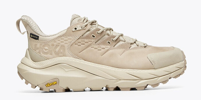

I browsed the Hoka selection and I’ve developed a taste for exotic modern fisherman sandals -
The hiking shoes are pretty wild- and ā€œengineered for a smooth ride.ā€

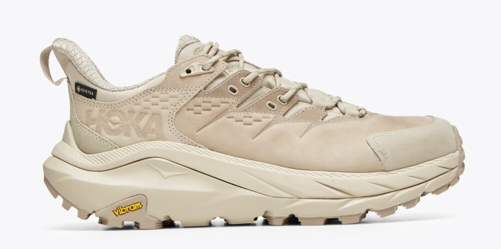

That’s interesting- I had another look and found these-
Which appear to have a negative heel rake! They look like a breeze to slip on.
Their website doesn’t include many images of people wearing specific shoes, but they do talk about this (sort of) in their technology page:
It’s vague and marketing-y but maybe there’s more going on than meets the eye.
A few brands have that style of heel @SHIELDS , definitely looks easy to slip on. I would worry about heel slippage when wearing. That can lead to minor irritation or blisters from prolonged wearing… but I have not tested them myself and I’d assume a company like Hoka that is known for comfort would have worked through that.

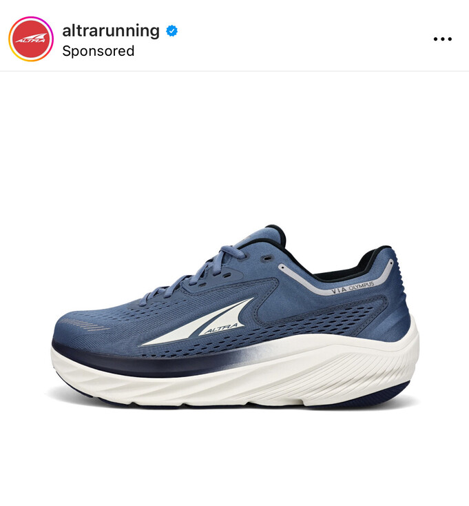

Some other products in the zone from performance brands:

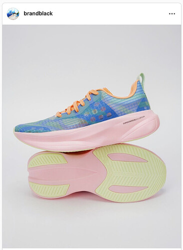

To lifestyle brands:

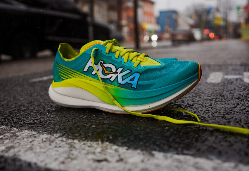

ICYMI, Hoka also just recently dropped their first real real super shoe. First peba midsole and viable Nike competitor from the sounds of the positive reviews I’ve seen. I haven’t had a chance to try it yet.
