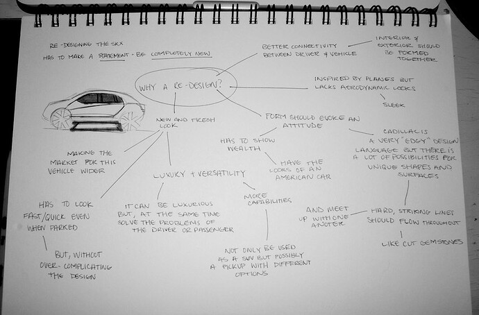

Mason, nice sketch. I think the side wind is a little funny because your B-Pillar is slanting forward when it should be slanting back. The absolute right edge is also slanting in at the bottom. If you exaggerate it slightly the other way, it will make the sketch feel more stable and grounded.
On a higher level, I still wonder what makes this the NEXT srx? Right now it looks like a variation of the current design.
That’s exactly what’s wrong! I saw it when I was finished :confused:
Also, good point, I want to try to push it farther out there and make it something very different.
Thanks for the comment!

Hey Michael, what do you think about this? Love to get feedback as this is where I’m trying to start.
That is a good exercise. Now try breaking down each f those clusters into descriptive words (you have started already, luxury, versatility, wealth, american, fast) and try to find a series of pictures that evokes the meaning of that word to you. By doing this you will start to build a palette of forms, colors and textures to inspire your theme. You can use that to break away from the current vehicle more easily.
Another way to do that is to start thinking about the packaging of the vehicle’s mechanicals. Is this a traditional combustion engine with an engine in the front? What would happen if the engine went under the front seats like the original Toyota Previa? What would happen if there were four small motors, one at each wheel? These questions might sound silly, but they may get you somewhere new.
Awesome, that will be very helpful I think. I always lack the inspirational aspect in the research phase and that is a good solution! Thanks for sharing!

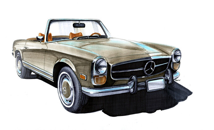

New illustration rendering. Mercedes 280SL. Done in copics, about 3-4 hours work.
Hot. I’d like to see a step by step progression of that…
I would, it’s just so time consuming and it is annoying to stop, scan…sketch, scan…etc. haha.
