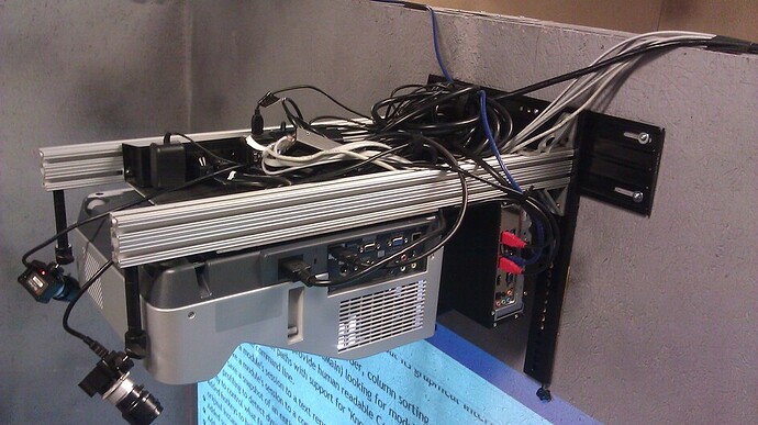

I have been tasked with covering up this electronics mess with something slick to slap our logo on. We’ve got 6 of these to cover.
The only things I’ve designed for production are small aluminum milled parts in SolidWorks. And we order these by the hundreds, not handful. I am very lost with this one.
Does anyone have any suggestions on where to start? The boss thinks a curved plastic cover would look cool. I was leaning towards some angular sheet metal. In any case, I wouldn’t know how to proceed down either of these paths. I would like to go with something that isn’t going to cost big $ up front in tooling.
Any suggestions or thoughts are welcome!
Thanks!
Dominic

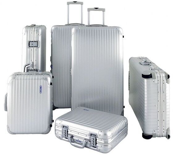

Getting a hold of some Rimova cases and reworking them…

It looks like a printer plus cameras on a gallery wall? Design a sheet metal enclosure of minimal parts that connect to the aluminum extrusions. Pay attention to safe installation - a guy on a ladder, cable management, thermal and perhaps acoustic issues. Add your company name and graphics via screen printing on the painted sheet metal or an adhesive, printed label.
On installations like this people are not going to notice the design of the shell, they will notice the utility of the application and that’s what you want your company name associated with, assured by a neat, tidy enclosure.
I bet you could do a pretty simple sheet metal part that locks into those grooves on your 2 extrusion rails to stay attached. Or maybe it slides on, in those grooves and has a slot for the cables, or it could just push cables down to the end

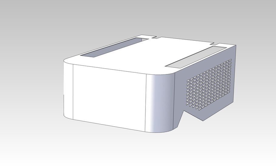

So, as I was designing this, it occurred to me that I really don’t know anything about sheet metal either. Is this something that a sheet metal shop could turn out quickly? Are the curves going to be a problem?
Thanks!
By the way, the overall dimensions of this are 28" x 18" x 10"
Curves are possible, but will present some problems for what you are trying to do. Time to complete will depend on the shop.
Should not be a problem to get the radius corners, it is a common technique in sheet metal. You might be limited to a radius that the fabrication shop has as tooling.
Alucobond type sheet can also be bent into that shape if a certain ratio to thickness is maintained.

From my experience with sheet metal, you should probably do a few sheet metal tutorials in your 3D program.
I use solidworks which has sheet metal tools. You might need to make you part as a top with the side part with curve as one part, bent then welded on the inside. Your holes look like they may need to be laser cut before assembly. Also keep an eye on how close your holes are to a joined edge. Attaching the adhesive medium to a very narrow edge would be problematic.
Rounded holes would be cheaper too.

Thanks for all the help. Thought you might like to see the finished product. Overall I am happy with the parts. There were some issues with fit and alignment, but nothing I couldn’t fix with spacers and a drill.
What do you think?
A couple of other notes:
  1. Removing the massive quantities of square holes helped to bring down the cost
  2. The bending process marred the front surface, so they had to weld on an extra plate for our logo (photoshopped out)
  3. This is for the military (hence the color and general bulkiness of the design)
