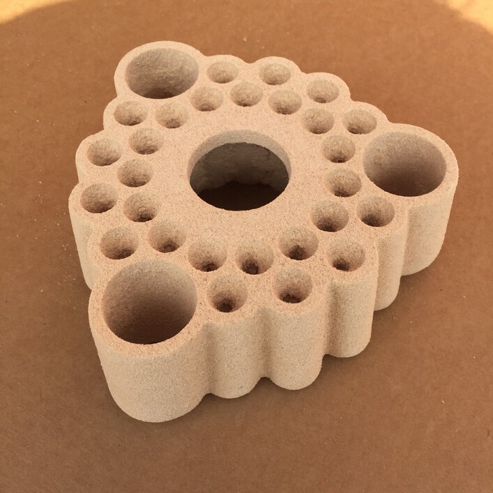

Getting there. Left this in the bed overnight and a lot of binder bled into the surrounding powder. Had to depowder it with a 100psi air gun, but the part mostly held together. I think less saturation and pulling it out right away then baking will be better. Apparently you can retrofit the heater to the 310, so that might be worth doing. The green strength of these parts is remarkably good.
Gave it a try, but straight Ultracal is totally useless. Even with the saturation maxed out, it just comes out like crumbly powder. Definitely needs something added.
