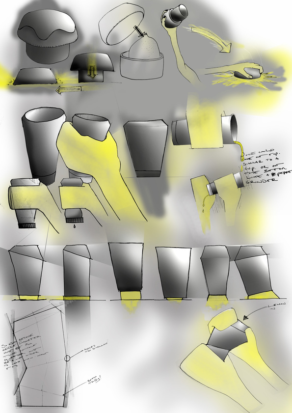

I’ve put a few of my portfolio attempts up on Core and have had feedback which always mentioned that I didnt include enough development work. So i have a few questions about the inclusion of development work into my existing portfolio’s
  1. Do i need to put more examples of sketching in (see attatched file) or should i do more to make my actual development process more obvious? also, how could i include the attatched sketching into my existing portfolio, which is: http://issuu.com/sdcrosla/docs/samuelcrosland
  2. Whenever I scan or photograph my sketches, i cant seem to make them clean enought to put into my portfolio. is there any tips or hints that anyone has about photoshopping them? i work in blue pencil usually.

As far as the image you posted, I think it could do without the photoshopped shadows. It’s very distracting and not well done.

i don’t really know what im looking at in the image attached to your post… doesn’t look very strong compared to the portfolio. i don’t really consider this “sketching”…maybe it’s just the sample, dunno. it’s obviously digital and doesn’t read very well. i’d rather see a nice pencil/pen sketch than an overworked digital one with not much content to it.

thanks for the help, its much appreciated. On my attatched picture above i was just giving an example of what i could include to show process work, also it was just one of my practices trying to do photoshop sketch rendering. but i’ll keep practising.

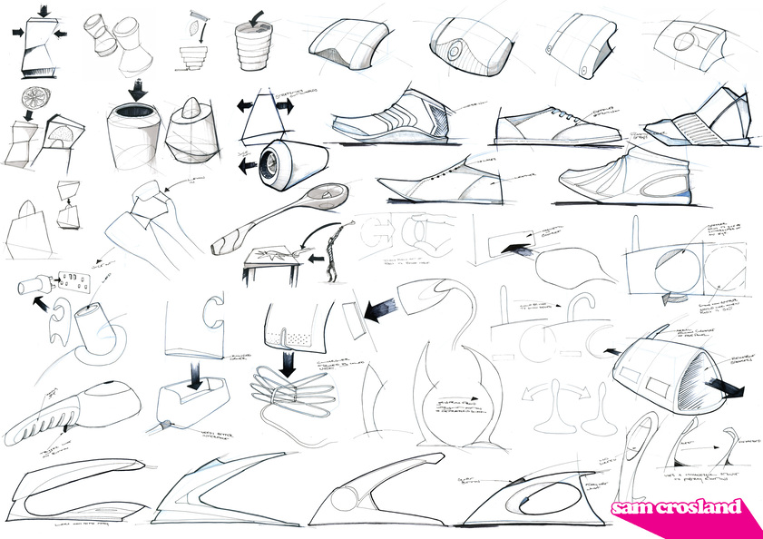

Ive done a composition page of sketches, without any shoddy photoshop work and attatched that. do you think something like that along with some examples of CAD, Modelmaking and other work would do for sending with my CV?
also, Should i just put a page of sketches in with my portfolio or should i try and link them in with my projects? because i spent a lot of time sorting the graphical composition of my portfolio and think it looks pretty good, i also think this is one of my strongest skills.

something like your above attached sketch page is better. You could show a compilation or within the context of a project.
Still, from my perspective, I’d say that if you could improve your sketch skills more, it would help round out your portfolio. You’ve got graphics, process, modeling and the thinking aspects in place pretty solid, I would say, but the sketching is a bit on the week side, and somehow within the context of your other strong skills it highlights this even more. Also, given this, I would be aware of how you present things, as it could come across as lots of sizzle and little steak. I know you aren’t likely trying to hide anything, but because of your strong graphics and layout, i’m getting this feeling a bit…
on the positive side, it’s a good thing that you have only one thing to concentrate on- sketching. the majority of portfolios out there not only need help in sketching, but also are weak in graphics, layout etc. You are ahead of the curve in that respect.

The sketches on the second image that you posted are really nice, they show off your skills way better than the photoshopped dev work. I wouldn’t have recognised them as the same person’s work.
