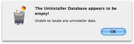

I recently tried Alias 2011, but due to severe bugs I was forced to downgrade to 2010.
But since Alias 2011 doesn’t come with an uninstaller all I could do was trash the application (OS X).
This seems to have messed up something in 2010 because whenever I try to open an .IGS file, it tells me that “directconnect” is not installed.
Before I installed Alias 2011 I did not get this error!
Alias 2010 does come with an uninstaller, but ever since I trashed 2011, the uninstaller claims that nothing is installed, even though I tested to re-install Alias 2010 once just to see what happens!

Thank you for the tip, unfortunately it did not make any difference.
I used CleanApp instead of AppZapper, since AppZapper hasn’t been updated in a very long time, and CleanApp has a nice community feature which enables you to see what files other users have found and delete them as well.
But since it was a no-go, I decided to dig around after the package receipt as see if I could get any information from the bill of materials that should be posted in /Library/Receipts. Imagine my surprise when there was none, except for the bloody uninstaller.
Back to square one. :frowning:
EDIT: I enabled one of CleanApps other features which is installer logging, and it showed that Alias drops its receipts in /private/var/db/receipts where actually most other receipts are stored as well, so my mistake on that one.

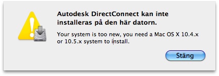

Even when you reinstalled 2010 it still failed?
I found a link on Autodesks site for the 2010 R1 installer for Mac, see if it lets you install this independently.
http://images.autodesk.com/adsk/files/autodesk_directconnect_2010_r1_english_osx.dmg
No, Alias 2010 for Mac does not disclose that it is installing DirectConnect 4.0, it does seem to uninstall it though (since it’s absolutely gone from my system).
Alias 2011 doesn’t disclose that it’s installing DirectConnect 5.0, and any user who trashes the application gets left with it in the Library.
Thank you for the link, it’s greatly appreciated, and it provided me with what I guess is the final clue as to why I don’t have it. The question now is, why didn’t the Alias 2010 installer let me know this? And the second question is of course… aarrrrggghhhhhh

Yup, Time Machine to the rescue. I have DirectConnect 4.0 back now.
Amazing that 2010 isn’t fully Snow Leopard compatible.
