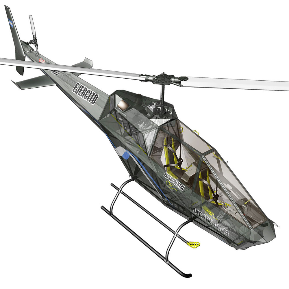

I attached here two more photos from the flight tests with a closer look of the cockpit.
thanks for your comments !

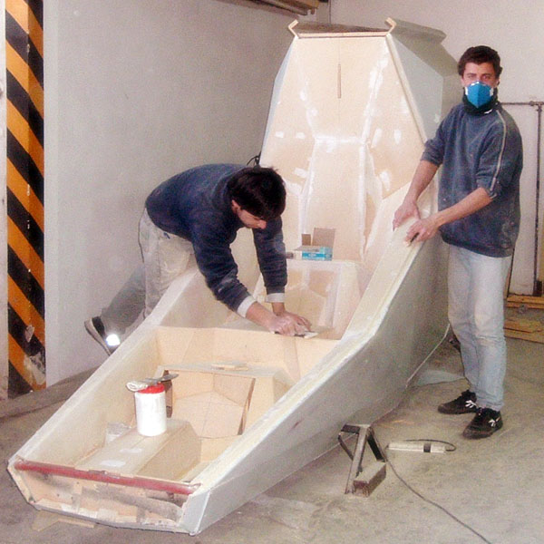

You also said you were responsible for the cockpit design, what about that? Can we see the interior and how does it relate to the whole project?
Can´t find photos from the interior here at home.
I´ll try to take some tomorrow.
I attached here a couple of drawings and a photo from the real model for composite material body and interior.
I´m the one with the blue mask !
cockpit images
comments and critics are welcome again
thanks !
