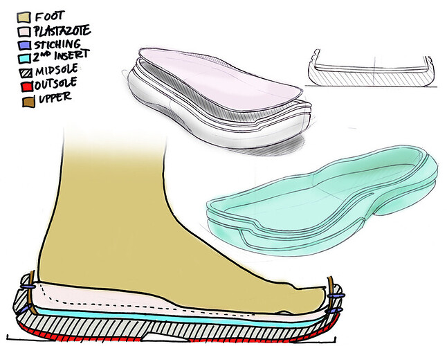

I design shoes for Diabetics, so maybe I can help. First, you are right about the last. The shoes you have in your photos not only have extra depth (about a half inch), they have two removeable footbeds at least and are lined with plastozote. These are the most extreme examples for diabetics and people with arthritis. There are less extreme examples that are more “normal” looking. I always try to remember something a consumer said to me. They were beautiful to her because they let her walk t the mail box.
I’m sure you are aware of the Theraputic Shoe Bill. People with Diabetes can be fully reimbursed by Medicare for shoes that are complient with a couple of rules. You can google it for the exact wording, but they need an adjustable closure, come in widths and have two footbeds. They should also have seamless linings, firm heel counters, and padded toplines. Be careful of multiple overlays especially in the forefoot flex area. Any rubbing in around the metatarsal heads can cause the ulcers you show. Ulcers, as you know, lead to amputations, so this is real stuff.
They aren’t in stores yet, but I just did a big project for Aetrex/Apex. I will post if I can get photos. Basically, I took the extra depth last and made a PU unit bottom with a lot of drop in depth. I sculpted it to make it look like it could be in the “comfort” area of the shoe store instead of the “orthopedic” part. Huge hit so far.

Neoprene is great because it is soft and stretchy. It is very gentle on the skin. The down side is that it is hot. Sweaty skin breaks down easier. not a good thing. Use it sparingly. Current solutions to making the shoes easy on/off involve openning the eyestay as wide as possible. I don’t think this is the only solution, but I encourage you to visit a pedorthist’s office and watch these shoes go on and off. A bootie may be more difficult and only add more bulk. Also the back pull tab shouldn’t go on the inside. It will rub on the heel. You should be able to put your hands inside the shoes and feel no lumps or bumps.
Also be careful where you place the seams and overlays in the forefoot. A pedorthist might want to modify the upper at the met heads and stitching in that area make it more difficult.
Your outsole will need a “cut here line”. A pedorthist will slice off the bottom of the sole, add bits and pieces to correct gate, and cement the sole back on. Outsoles that arch up in the middle may make that more difficult.

The new Aetrex shoes aren’t out yet. The “cut here” line is a guide to remove the bottom 5mm or so of the sole, build up the midsole according to prescription, then reattach the sole. It helps them not cut through the lasting board and ruin the shoe.

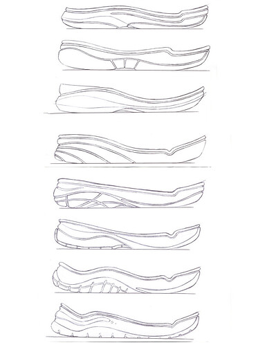

In the meantime, I spent the majority of my summer break (its over now) sketching and really trying to identify a set aesthetic for the upper and the sole. Since the sole is such an important aspect of the shoe, it was necessary to explore some different side profiles.
The section view above, shows the concept in action. The objective is to set the foot lower in the sole, allowing for a less bulky upper. By designing and sculpting the sole of the shoe, the shoe should become visually lower, ridding it of the visual cues of most diabetic footwear. The cupsole construction offers good side to side wall support and allows for removeable inserts to give added depth if needed. The concept seems solid, but if there are any mistakes or issues I may have overlooked, please feel free to correct me.
Here, I have explored as few more designs for the upper and a potential bootie design. More to come in the next few days, 10 weeks left so I have my work set for me.

Interesting project. Looking forward to see how it turns out. For visual reference, the KEEN stuff all has big toe boxes, almost exaggerated. The bottom left sketch has a little of that feel.
Nice drawings Yurri.
some very nice ideas also for"normal" shoes I would say.
Also the topview study is very nice.

Good stuff Yurri. Look into adding a paint hit on the sidewall to visually slim it. This Nike Air Morrie (Designed by Mark Smith and crew I believe…) has a pretty high midsole, but the painted sidewall helps visually cut it by almost 1/3.
