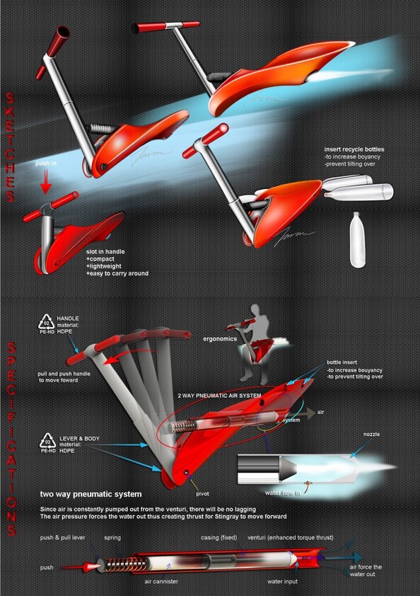

its a blow molding process, so air is trap in the stingray itself…
secondly, the empty water bottles (air trap inside) enhanced the buoyancy and the stability
thirdly, the concave seat at the rear create buoyancy effect too…

If you’re still working on this project (not sure if it’s a class project you’re already done with) I would try to come up with a way to get LOTS more bottles in that design. If the bottles are your main way of creating buoyancy, you’ll need more like 30 bottles, not 6. Maybe they’re contained in a net? Not sure.
I do like the shape of the seat, very cool and sculpted, so keep that element in there somehow. This could be something you revisit when you circle back around and start re-vamping projects for your portfolio. The kernel of the idea is there, it just needs some more development.
Sorry, one more thing. You might want some sort of footholds so you have something to brace yourself as you pull backwards.
