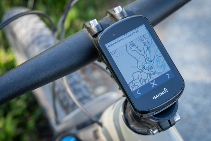

My spouse/kids knows of this and just recently surprised me with a Garmin 530 for father’s day, see pic below. “Small” turn-by-turn navigation I can use with any bike anywhere in the world. Syncs with ridewithgps, and it provides speed, distance, tracks to the cloud, and other stuff too.
Outside dims are 85mm x 50mm. A little smaller would be ideal for me, but much smaller than my phone. My problem? It is 17mm thick. Like a freaking Palm Pilot from the mid-90s. wtf? The buttons are these harsh snap domes, again from the mid-90s. Micro USB? I mean, this is the latest and greatest second-tier (their 830 is the top) bike computer on the market and the tech is just plain old. Anyone know why?

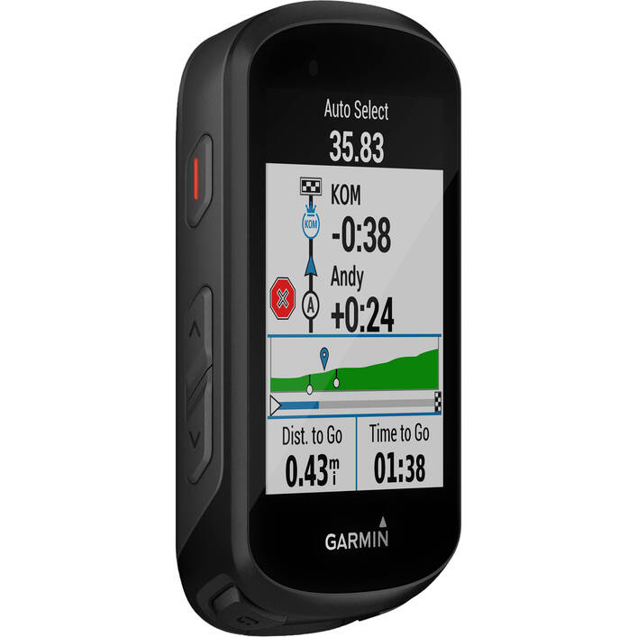

iab, sorry you were disappointed with the Edge 530. We approached the design as a purpose built product for cycling. Our decisions are based on what is best for being used while on the bike.
As many have mentioned the thickness is driven by the battery, which gives users up to 20 hours of battery life (some have experienced longer in real world tests). While many cyclists won’t be on the bike that long we want to make sure those who are riding for 15 to 20 hours have enough battery life to track their entire ride. We constantly balancing size and performance. In this case we focused on minimizing the height and width as much as we could with the display that was selected. This is what the rider sees while on the bike, so we didn’t want it to look bigger than it needed to be. We had a battery capacity target and in the end minimizing the footprint pushed the thickness a bit. We felt it was a fair trade off for the performance and look on the bike.
The switches are tact switches. Selected to give tactile feedback when wearing gloves and out riding in rough terrain like mountain biking or gravel.
The micro USB was an engineering decision, so I don’t know all the details. I do know that having easy access to a charge cable was a consideration. We wanted someone to be able to pick one up while traveling if they forgot theirs.
