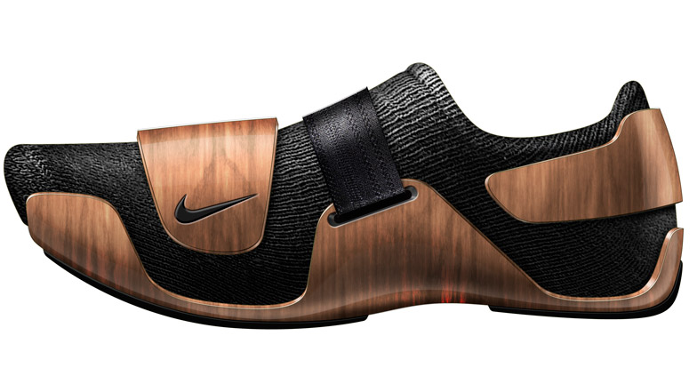

Concept 2
Concept 2 Idea:
This idea is based off using the Eames itself as design inspiration. When I was looking at the first slide in this deck I noticed how the wooden panels seemed to be floating on the black leather back ground. The wood panels have a unique shape to them that allows them to flex into each other. I though could we apply the same idea to footwear “panels”
The rigid panels reminded me of Knight Greaves. AS they are made from very stiff panels that are joined in such a way that allows for a good deal of flexibility. I’m sure there is better imagery for rigid panels on a fabric substrate, that allow for movement. Hockey pads maybe? Couldn’t think of exactly what to search for. Sure it’'ll hit me later

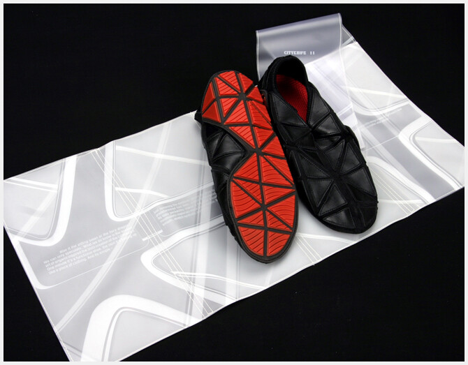

Eman, have you seen the Nike Cityknife 2?
Never heard of it, But I googled it just now. Looks like I’m 11 years too late to the party. :confused: Also looks like you did the CityKnife 3 too.
But exactly what I thought the cross between the two concepts would be. But good to see that the concept would in fact work.
Looks like theres even a pair on eBay right now

It’s all been done. The concept for that shoe was inspired by a purse by Isaac Mizrahi.
What matters is what you bring to it? How will you advance it? Don’t give up, make it new.

You and this guy must be following the same pinterest boards :smiley:
Haha that’s an awesome coincidence. Think I can take it a step beyond a render though
