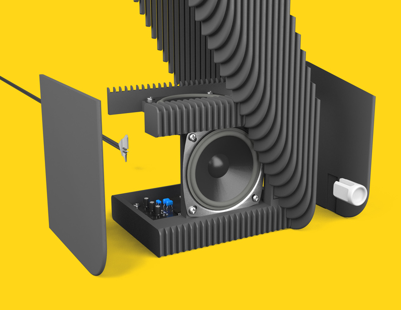

The idea of this speaker was take the speaker grill and abstract it so that the whole speaker body acted like a grill and let sound pass through it.

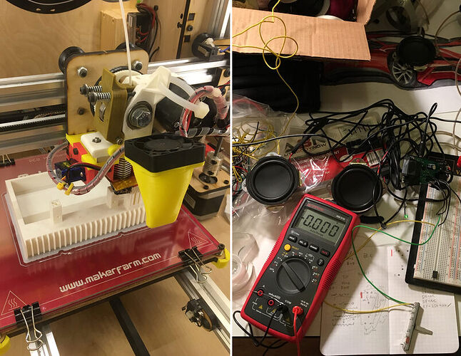

The nature of the construction you have chosen (individual vertical slats) really highlights ANY imperfections in your parts, alignment, gaps, and tolerance. For this reason, your renderings are more successful than the physical model images for beauty shots. I would show a couple shots of the physical model, but would limit them to the more informative/construction level, not for aesthetics unless you plan on creating a new/better/more precise physical model. I would also point out that the issues you are having in your own physical model may be an indicator of issues you could see in production if you intended to assemble it in a similar manner, this could also be used as manufacturing/assembly key learning that could lead to you ultimately reconsidering how you would go about manufacturing or assembling the product. In that case, I would use the the physical model images, call out the imperfections (especially the the top back edge line) and show the corrective actions you took to eliminate the issues you found in this model.

Something you wouldn’t know if you have never worked on speakers is that deep slats are bad for sound. The waves bounce off those layers and start canceling or distorting each other, so those slats would need to be as thin as possible in the cone of interference from the driver. An acoustic engineer would want to make them about 1-2mm thick (like I said, ver thin) which owl make them look not very good, so then you would need to back them with scrim… not a level I would expect from a student. but I know you geek out o this stuff, so I thought you would like to know that.
A few examples of this in production products I’ve worked on:
Polk Camden Square. Notice how thin depth wise the lattice is, you especially want that in front of tweeters because the wavelengths are shorter. Not important in front of woofers, mid range drivers you could got a few mils deeper: https://www.polkaudio.com/products/camden-square
Polk N1. This bar didn’t have tweeters, but instead had an array of mid woofers, so we got away with more depth, probably about 5-6mm: https://www.polkaudio.com/products/n1-gaming-sound-bar
Lastly, doesn’t have slats, but a similar square form factor. Here we tough advantage of the huge size to have very directional left and right tweeter array (4 tweeters at various angles) then a giant upward facing woofer and mid range: Definitive Technology's Cube | Wireless Bluetooth Speaker - YouTube
OK, lastly, I’d like to see you align the visuals. The design is a cube with a triangle lopped off. The fins have a radius on the ends. Make everything relate to that. Where the AC cord comes in can have more of this feel, at least use the same rads on the part. The volume slider is a circle, I’d expect to turn a circle. If it was more of a triangular thing it would have visually said “slide me” more. Also, I could see some LEDs behind those slats to show volume level or mode or something?

Thanks a lot for the feedback. That’s a really good point about calling out the imperfections on the physical model. I should totally use it and the issues I had making it to feed directly into improvements for rev 2 of the model. That will also let me end with some new and improved beauty shots. Great ideas!

Nice process, I love that you actually made a functional model.

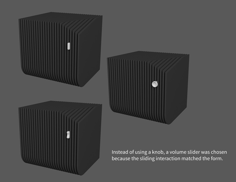

Hey Gerry,
A few notes:
  • The slider looks like a push button or a dial, definitely not a slider. That being said, the way it’s integrated with the housing is clever.
  • Overall presentation is clean. Nice.
  • Love to see the prototyping.
  • You say “low cost speakers are designed for manufacturing, not for the users.” But then you don’t solve a user-centered problem. If you’re adding value by refining the form, that’s fine! Don’t try to make the project sound like something it isn’t.
