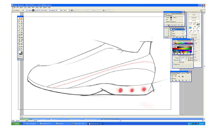

Thanks for the response Yo, as far as design I found an old sketch I did of a shoe for an Alias Paint class I took last year, and started tracing over it. I agree the design is pretty weak and unresolved. I just wanted to see if I could render a shoe at all. I’m going to do one more of a Reebok Ventilator that I have just for fun (lots of vinyl and color). Then I might focus more of some solid designs. Shoes are freakin’ hard.
I have been doing a little bit of sketching, but I giving myself a little breather over the holiday’s to make sure I stay excited about working. Its easier for me to get motivated to do a rendering because you get this pretty thing to show off afterwards, and there isn’t a lot of thought.
For those that are interested here is the original sketch.
and here is my illustrator linework:
