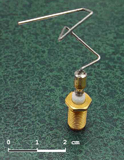

One of the first physical objects that gets cited as being designed by AI are extremely high performance âevolved antennasâ that were designed by NASA and some affiliated academics with work beginning in the early 90s.
They were designed through genetic algorithms. While thatâs on the dumb side of artificial intelligence it does still fit most definitions. I think a key part of the outcome is that it wasnât simply a predictable optimization. From what I understand, the engineers were surprised by some of the solutions and were able to get significant improvements over human designed antennae.

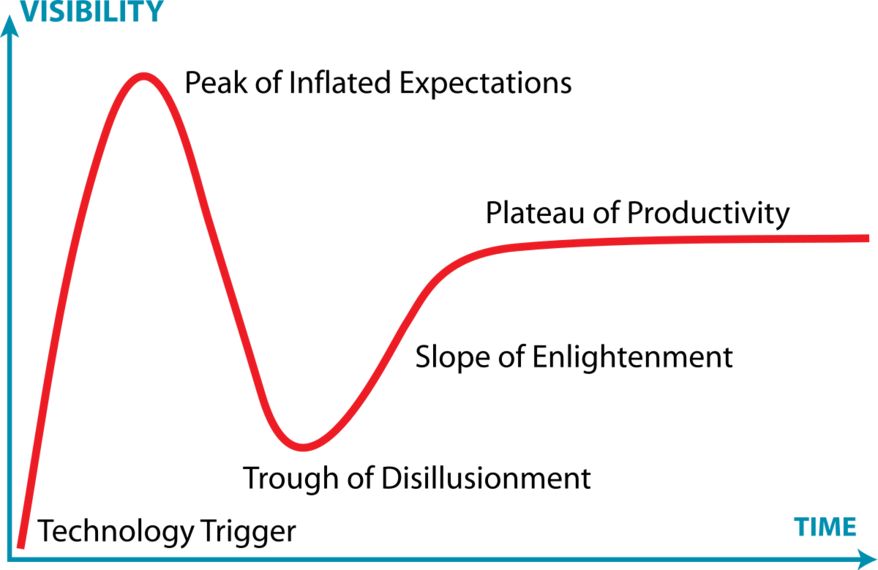

In the big picture real, I see problems approaching the business and marketing side of design work. For example WeWork has been talking about how they are using machine learning to predict the number and size of meeting rooms to put in a new coworking space based on usage data from existing coworking spaces. Data science has certainly been a part of many corporations to help answer business type questions in the last decade, but I could imagine the type of questions being looked at becoming more design related. Though to quote Daniel Davis, one of the researchers at WeWork, Why are you looking at AI tools if your company isnât even using basic statistics? Itâs a great reminder of the hype surrounding AI/machine learning and that thereâs a lot to be learned by just objectively looking at business data and questioning the status quo.
