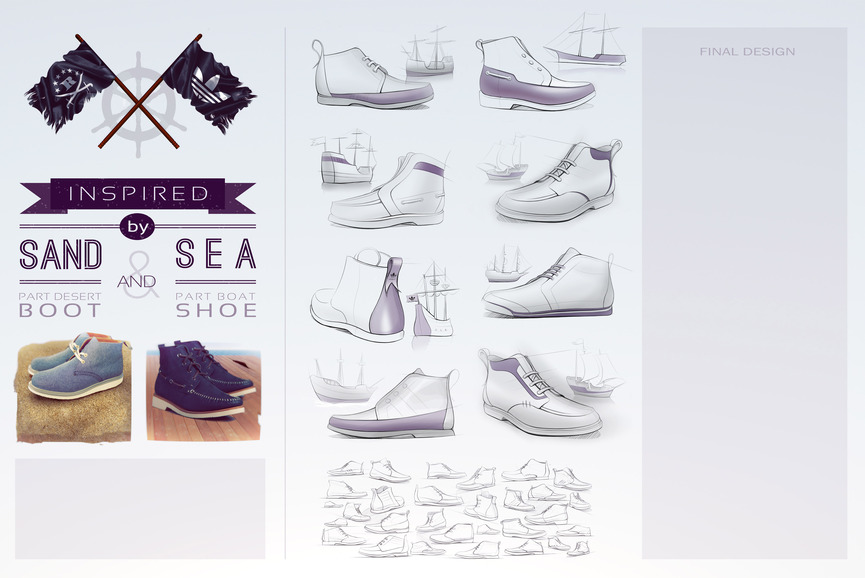

Here are some of the sketches I’ve started on.

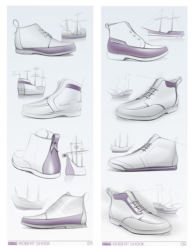

This is the one I put up in Sketch Fu, trying to get familiar with the proportions of a shoe.
And with these my thought was to look at pirate ships for inspiration.
I tried to highlight what parts of the ship I was looking at, though I wouldn’t necessarily put those colors there.
Only the more simple lines seemed to make sense on a shoe.
At first, my plan was to continue in this kind of direction
and then find some unique details to make the design original.
That would work out great for my drawing class but I wonder if I’d have something original enough for the competition.
Sketches and proportion are great. Solid start for your first footwear project. I’d like to see more push on design, construction and branding. What make these any different than shoes already on the market? What makes them Adidas? Ransom? What are the details?..
Another rule I follow/created is the 10/2/1 rule. What do you see at 10’ from the across the room? What new do you see at 2’ in front of the shoe shelf? What do you see at 1’ when you pick it up or trying it on?..
this is great advice, couldnt agree more.
also, for lifestyle/casual footwear, remember what makes it just that, and not athletic; materials (often leather and not man made though many exveptions), color (often accents of color on more traditional palette vs all over bright colors). at the same time what helps define this is the brand and the consumer, have a direction there first before sketching.
also casual shoes usually come in a collection sharing the outsole tooling, not just a 1 off pattern, the boot or boat shoe may be your ‘hero’ pattern but how can you create a 3 pattern collection that covers of the various wearing needs for your target audience.
sketching looks good from a technique standpoint. like to see where you take it.

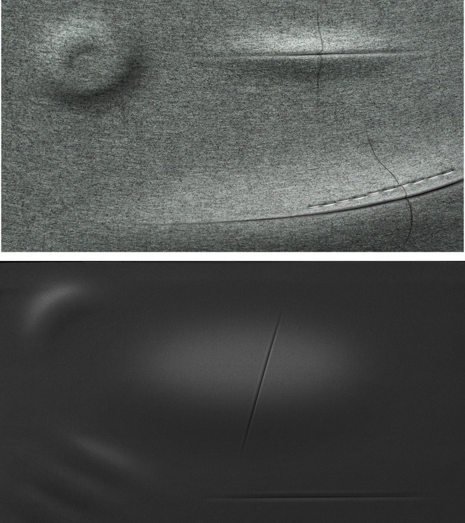

Here’s some progress on the work for my drawing class
Practicing rendering fabrics
A idea for a color palette
One of two boards for the class, The other board will be a rendered-out hero shot
Rob, love those refer trials!
Awesome rendering practice, love the subtlety of the canvas texture on the dark gray one. Looking forward to seeing the final design.
