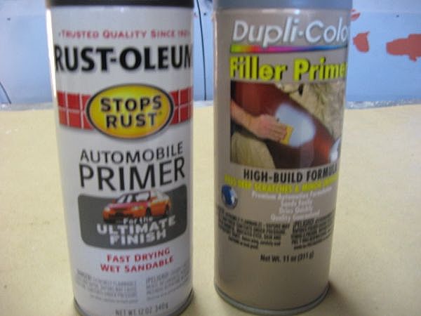

My school has a zcorp machine and I actually love it for finished models. Take a model straight out of the machine and sand it VERY carefully to get rid of the stair steps, then dilute some fiberglass resin with acetone and spread it on in 3 or 4 thin coats. Because it is thinned, it seeps into the pores rather than just globbing on. It ends up quite strong and quite smooth. then just a little more sanding, prime and paint. I always use auto body paints and a “sandable primer”, it is a thicker primer to fill any tiny holes. You can get spray paint cans of it for cheap at any autozone, checker, schucks, or whatever.
We have an FDM printer & I have found that floating a thin surface of body filler or glazing putty with a bondo spatula works well. Apply the filler just enough to fill in the steps, then wet sand it smooth with 400 or 600 grit sandpaper. Then prime, paint and dazzle!

Here’s my formula for finishing Zcorp prints
  1. Quick sanding to remove really high spots - but leave some ridges for yourself be able to tell when your at your CAD surface (you don’t want to sand too much off)
  2. Wear a mask while dripping some water-thin CA (ZAP works) onto the surface. you want to do this slowly because the reaction that happens will cause heat\ warping in thin walls if you move too quickly.
  3. Once the entire surface has been hardened and has cooled (done reacting) shoot it with some good filler primer (evercoat is the best). After drying another sanding to sand down the ridges - use the ridges as a guide coat to see when you’ve made it down to an even surface.
  4. Use glazing putty to fill in any cracks\ pits\ remaining ridges - this stuff is great but you have to apply it very thin and quickly - also you’re doing this in a well ventilated are - same place you would paint.
  5. Sand from 220 - 600 - more surfacer then continue with wet sanding till you’re happy with the finish -
