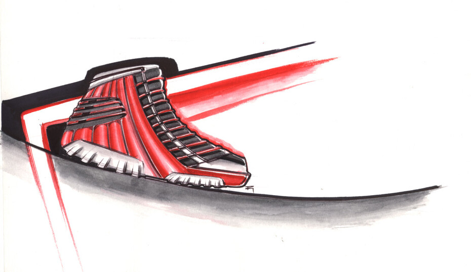

Feedback required on sketching,surfaces,rendering etc etc..
Pls give feedback…render medium - Photo inks and permanent markers…
basketball shoes
criticisms are most welcome…how i can improve further…what i have to work on etc etc
do them just in grayscale and try to emphasize depth, shape and curvature.
also, try using a template for a more pleasing overall shape. tracing isn’t cheating.

Your forms are very simple, rigid and plain likewise some of the perspective is way off.
The dynamism and drama of the sketches also aren’t present.
Dont even bother rendering your sketches at the moment until you sort out line quality, line width and perspective. Colouring in a badly drawn sketch isn’t going to make it any better. Some of the best sketches i have ever seen is Carl Liu’s linework sketches of the PDA he did at Astro.
There is oodles and oodles of stuff to inspire you here. Yo and blaster to name a few. They have kindly uploaded tons of sketches look at them analyse them and attempt to re-create the magic. Also there are a alot of books out there Design Sketching, Comsic motors, Car liu Design book, Sketch to name a few as well as all scott robertsons.
Spend time drawing lots fo boxes in different angles, focusing on line weight quality likewise with elipses draw lots and lots of them, then just start drawing lots of different profiles and mould them to explore form.
