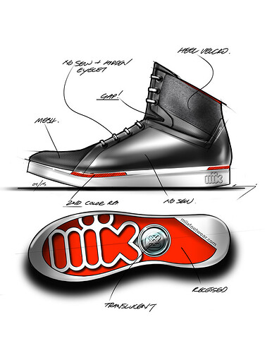

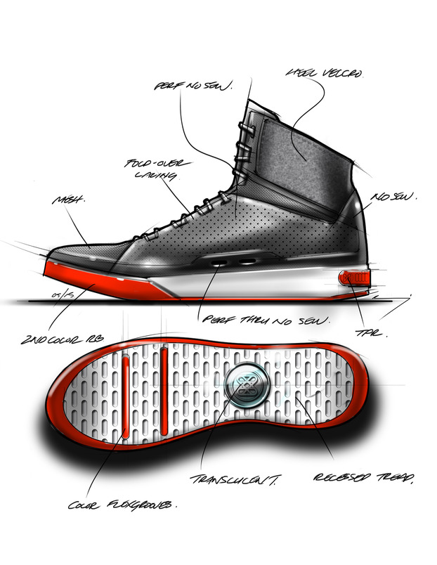

I experimented with similar vulc/cupsole design on some lifestyle sneakers a while ago-
