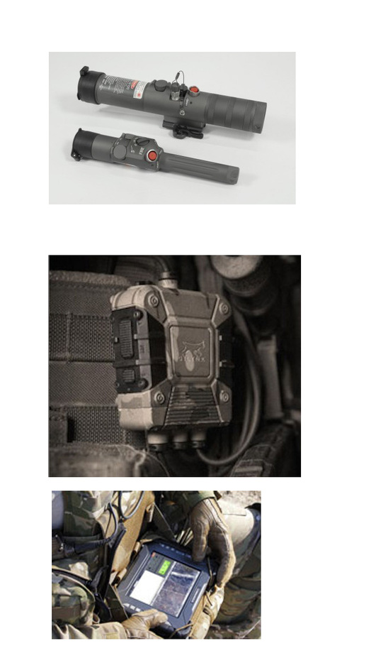

We incorporate a lot of OTS switches and controllers from OTTO, Greyhill and other mil spec switch companies in our military specific design systems. It is a constant challenge to design ruggedized systems that allow the user to control said objects in volatile arenas with no or little user error due to design. Apache block III hand controls for gunner station, safety and firing mechanisms on guns, integrated computer systems with touch screen capabilities. Are you looking for something in particular or just looking for a chat?
Thanks for a great start on this post! @JWedge I am not looking for anything specific more for ideas and inspiration and discussion. What is the image in the middle of your post? I have a particular interest in mechanisms that are designed to provide additional user feedback to the users hands. These mechanisms would help operate a system that otherwise would be difficult for the user to interact with because of vibration/temperature/physical and mental demands.
It is a PTT. push to talk device that links your radio comms to a headset.
