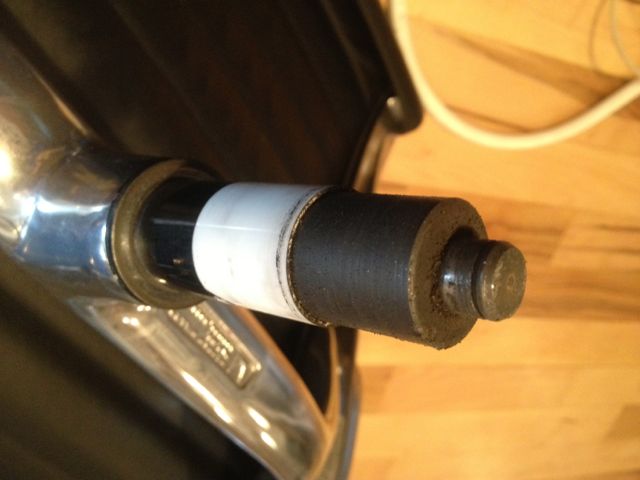

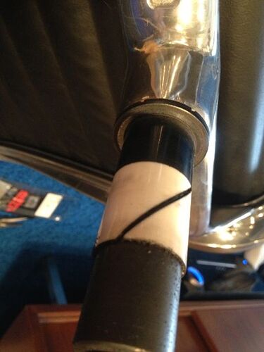

  1. The chair is a bit wiggly where the seat post goes into the base. I’ve tried everything I can think of- spinning the chairs repeatedly clockwise and counter clockwise. Looking for some kind of nut to tighten, etc. No luck. Seems as if there is a washer of some sort inside that (visible with two little holes in- shown fitting into place when upside down) makes things stable if I pull up on the chair by 0.125", but with gravity, it’s not fitting into place.

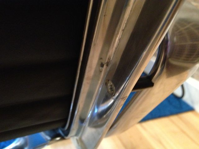

  2. There is a screw that holds the arms on through the main side frame that is 1/4" loose. Thing is, I can’t tighten or loosen it. Seems stuck, binding in the metal thread, perhaps.

Pretty sure thats a snap ring in the last shot. Not sure if that would hold the whole thing together, but could be a good place to start
Some sort of a special tool like super sharp needle nose pliers to get that out?
Something similar to this should do the trick.
  1. Your steel screw and aluminum arm can create what is called a galvanic bond. Very common in the bike world. Try soaking the threads in ammonia.

I used to work on Alum group chairs - at an old workplace, a weld in the base would break and a couple times a year a broken chair would get tossed. I’d fish them out of the dumpsters and re-weld them. I’ve definitely taken the arms off before with those screws, and I think it’s just lock tite they originally used.
In your case, it seems you could either force it, possibly damaging the threads or carefully put in a spacer to take up the gap.

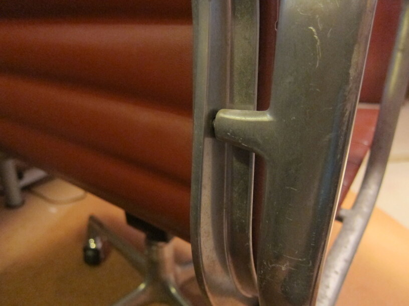

The arm connection has always bugged me, not sure if it always used those plastic tube spacers, I doubt it. I think the originals had that spacer cast in the aluminum, which would have been fragile. You should be able to tighten that up, I’d try to take it out in case the hole isn’t drilled and tapped deep enough.

I can CFM the original had the spacers as part of the same cast aluminum as the arm. It’s like that on my Soft Pad Group desk chair which is from the 80’s.

I checked our library of HM books, its interesting, most of the original product shots have the connectors cast in the aluminum (like Travis’s), but there are a few images of our particular chair that has the plastic spacer, some in a group shot with the other arms in the same photo. 80s products are still decades into the lifespan, when they cost reduced everything to death. I’ll ask next time I am there.

To fix the arm, I had to take off the bottom seat support, then remove all the other screws and use a screwdriver to hold the screw and turn the arm to maximize leverage. When I got it out, I saw it was slightly bent, and I suppose had been half put in to a point where the threads were catching. With the arm off, I screwed it back in, making new threads by applying a bit of force. Then I could put it all back together (putting the seat support on is a pain though as all 4 screws must go in perfect or they get caught on the soft aluminum threads).
Fixing the wobbly was easy, with the right tool. I first got a pair of adjustable (replacement head) spring clip pliers, but they were too bulk to fit into the recessed seat post. Then I tried small nails, but impossible to get leverage. Then I tried (4 times) crazy gluing pins onto the end of a needle nose pliers. I tried fishing around with forks, knives, jeweler screwdrivers…
…finally found a proper tool shop and got a very pointy needle nosed pliers.
It was working, but the width of the handle made it impossible to spread the pliers to remove the external spring clip. I trimmed the handle plastic with an exacto.
Once off, I could see the seatpost assembly. I dunno what HM was talking about, there is no permanent press-fit plastic part. Instead. There are 2 plastic collets. Both seemed in good condition (the slit is not a crack, it is the exact same on both chairs and both parts).
I have honestly no idea what the problem is, as everything looked intact, only thing I can thing of if there was somehow some part missing, but have no idea how it would get out. The spring clips and inside did not look tampered with. Just seemed like a tolerance issue.
To fix, I just wrapped a few layers of plumbing teflon tape around, and… done. Now the fit is tight, still swivels, no wobble and the teflon tape should hold up well to the bit of friction I think. I didn’t replace the spring clips (apparently also called Jesus Clips, becuase when you try to get them off they go flying and make you say “Jesus!!!”), incase the teflon tape wears over time and I need to add more tape.
